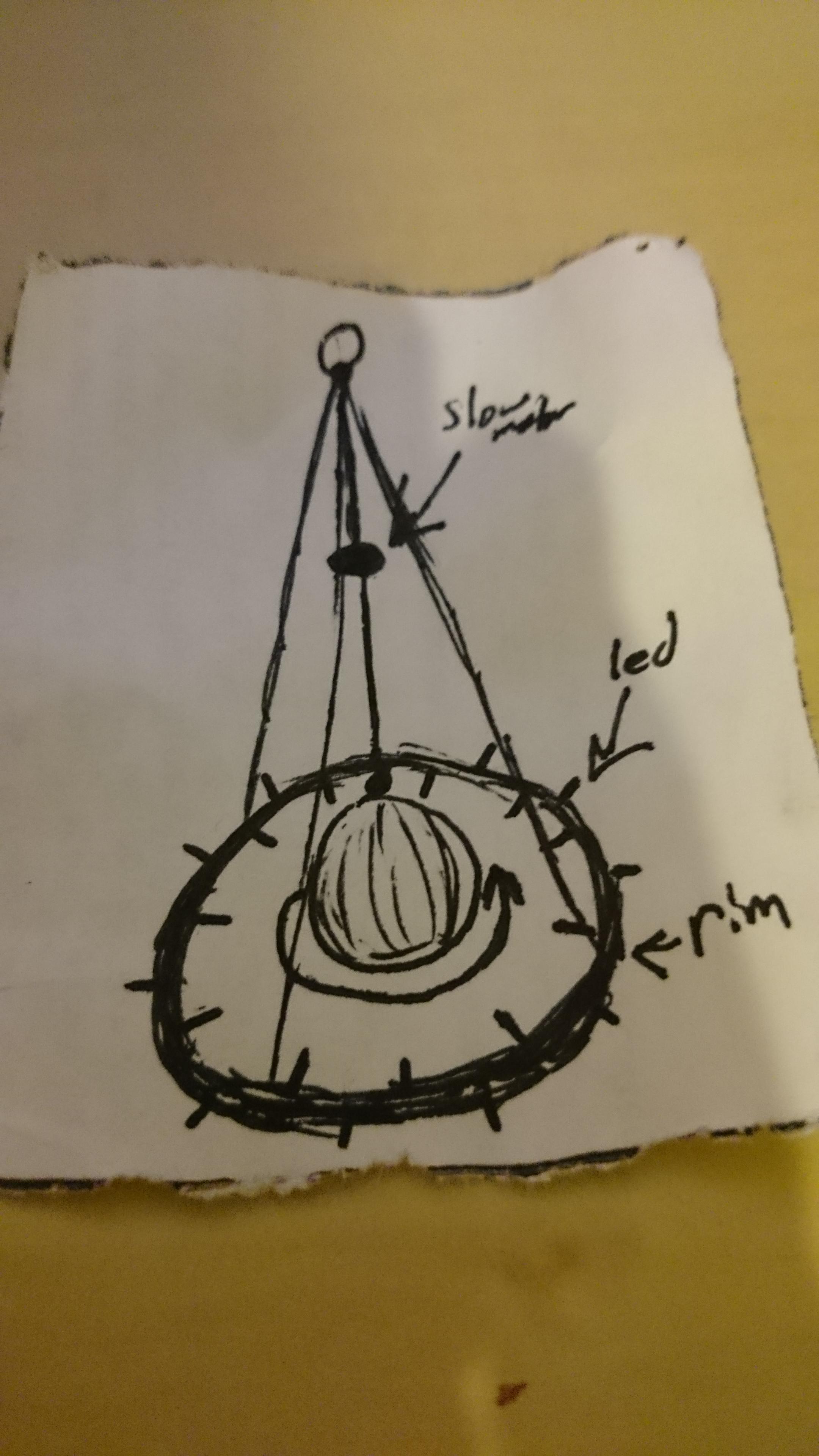

The goal is to make a battery powered trippy light that will hang from the center of a pop-up (EZ UP) tent at a music festival, and I need some help flushing out my ideas. I am a software engineer, so I am not worried about the programming side. I only have basic experience with arduinos, and zero experience with addressable LED (I have some samples in the mail so I can start playing around). I am also comfortable with basic soldering.
Check out my rough sketch and basic idea linked below. Basically I want to get a 8" mirror disco ball suspended in the middle of a bicycle rim. The mirrored disco ball will be attached to a slow moving motor (example = Amazon.com - American DJ heavy duty mirror ball motor 3rpm for up to a 12" mirror ball and under - Mirror Balls And Accessories ) .
I want to line both sides of the bike rim with addressable RGB leds. I am thinking I could widen the spoke holes and push leds through the rim towards the center. These would illuminate and reflect off the mirror disco ball. From my initial research, something like this seems like it could work. (12mm Diffused Thin Digital RGB LED Pixels (Strand of 25) [WS2801] : ID 322 : Adafruit Industries, Unique & fun DIY electronics and kits)
Pointing out away from the center, I thought it would look cool to use the higher density LED strips like neopixels.

That’s good news, so no red flags in my initial idea?
I’m not an expert but I see no reason why you can’t do what you want?
Your main problem is having the first pixel so far from the controller. Use a small controller, like an arduino pro micro or a teensy 3.2, and secure it to the backside of one of the LED strips. That way your controller is close and you are just running power a distance of 10-15 feet. Depending on the number of LEDs and the current draw you will need to increase your wire gauge to make sure 5v is making it to the strips. One thing to note: if you use a Teensy 3.2 you will need to apply power to the VIN which has a voltage regulator. My recommendation for LED strips is 60ppm WS2812b strips. They are easy to work with and forgiving. I would use two strips each with their own data line. Make sure to inject power and ground at the beginning, middle, and end of each strip. This needs to come straight from the power supply and not from the micro controller. My last suggestion regards the string that suspends the wheel rim. I would make it rigid if possible to keep it from spinning and twisting your power lines. I know it will make for a more difficult build and will take up more space when transporting, but festival goers are not known to be smart and respectful people. It will take one enthusiastic person to spin your bike rim to break everything. Good luck and share pictures.

@Matt_Richard Woah thanks for all the suggestions! For the rigidity of the rim, I was thinking about recycling some worn out bike chains and attaching them so the chain’s pins would be parallel to the rim. I was thinking this would allow the support to collapse vertically and limit the twisting/spinning.

I have been spending sometime with FastLED, and having loads of fun. I set up a quick test using the strand of WS2801 leds poking through the spoke holes towards the mirror ball. It seems like the leds are too diffused and fail to create the reflecting squares of light around the room. The 12mm leds and wires also take up a good bit of room on the rim. I am starting to think about other options. Does anyone have other ideas of what might reflect off the mirror ball better?
