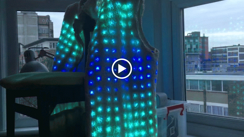

Hey @Stefan_Petrick , I adapted your “Animation 22” to the Technocolour Dreamcoat and it looks ace! I fiddled the constants a bit and added a 2D blur over everything. Interesting how the “timbre” of the colours change as I adjust the mic volume.
Great, @Robert_Atkins ! Is it still the same jacket I touched already?
Yup! New hardware though—added an MSEQ7 as I can’t do FFT in software because they’re three-wire strips and don’t play well with interrupts.
Btw: What is the additional 2d blur contributing? It seems to me that you are basically calculating one vertical line and copying this one around. So my question is what is the 2D blur doing differently compared the last line of the animation22 code?
And now for something completely different: Because the MSGEQ7 data contains always a remarkable noise level (together with a mic even more I guess) I tested some very simple “data noise cancelling” - something like if (bands[1] < 70) bands[1] = 0; in order to get more contrast (more black to be precise) into the animation. Looking forward to seeing the Dreamcoat in action again one day! Greetings!
I’m using a blur of 64, so I think it’s spreading it over more lines. It did seem smoother when I eyeballed it, anyhow. I’ll try the “noise cancelling” tip. Was also thinking of taking a rolling average over 3-5 samples and checking if that was over a threshold to get more solid beat detection.
