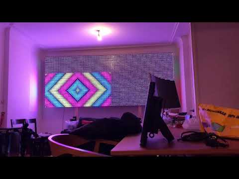

youtu.be - Esp32 WiFi 64x32 glediator
No increase of buffer for the WiFi but couple of programming tweaks and use of the second core. 64x32 pixels 16 universes #glediator #eps32 16 output.
