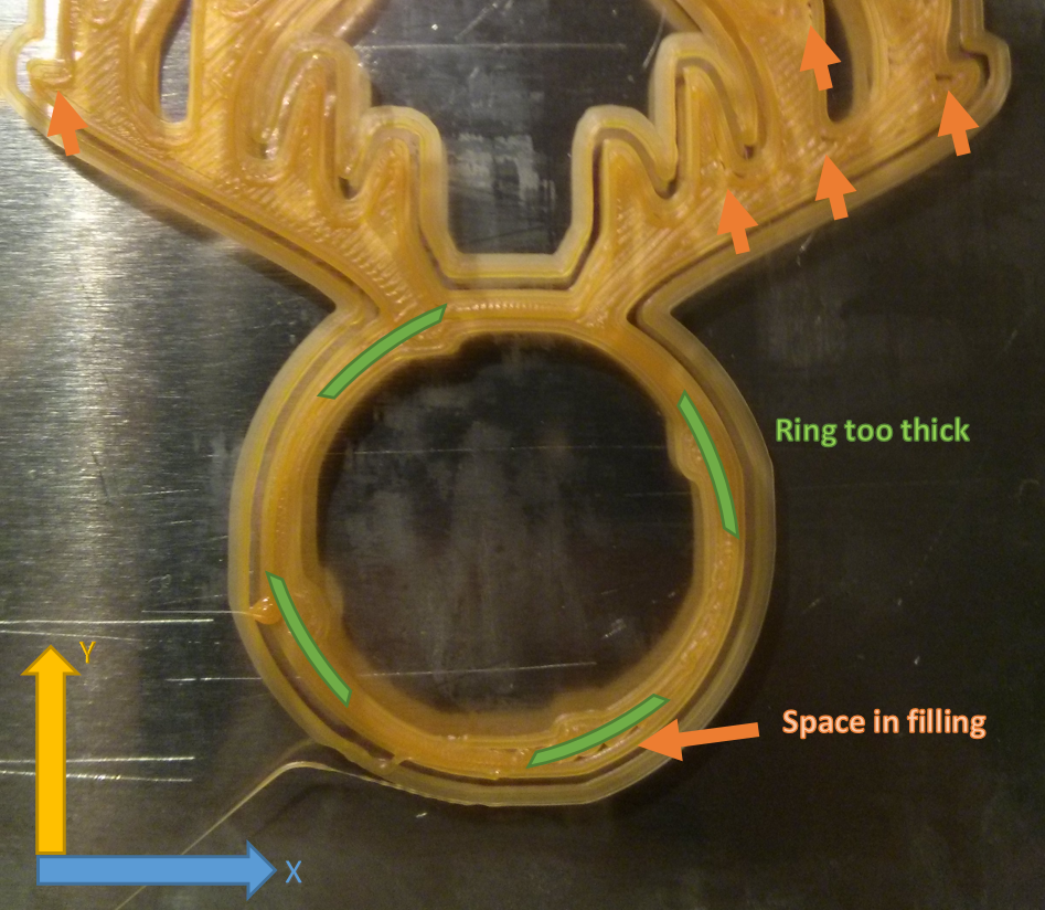

Hey there. After a long time i’m back. Had some ups and downs with my eustathios the last months. but nothing i can’t solve. But now i’m a little bit clueless. The printer seems to have problems with diagonal movements. I can not find any fault in the mechanics. Some ideas? Am i blind?

Notice how the outer perimeter of the circle below has flats on the top, bottom and sides. I had something similar once. I think you might be experiencing some backlash issues, meaning some play somewhere in your x and y axes.
@SirGeekALot i dont think this is the problem. The problem occurs after reassembling the mechanics. Changed linear ball bearings to friction bearing. I have aligned the 10mm rods to each other and the 8mm rods in parallel to them. belt tension seems to be ok too.
Oh and i tested some other rings. same problem. rectangles have nice outline dimensions but same problem with spaces when printing diagonal infill.
This is 100% a backlash issue. @Jeff_DeMaagd hit the nail on the head.
@Florian_Schutte Considering the fact you have just reassembled it, I have to agree with @Jeff_DeMaagd and @ThantiK .
Grub screws on pulleys should be pretty tight onto rods Given the consistency of the defect, id be looking at the individual pulleys on the motors (pulley grub screw flapping on a motor shaft flat?) , or the secondary pulley from the motor to driven axis shaft, as opposed to one of the opposing pulley pairs for each axis (if that makes sense?).
