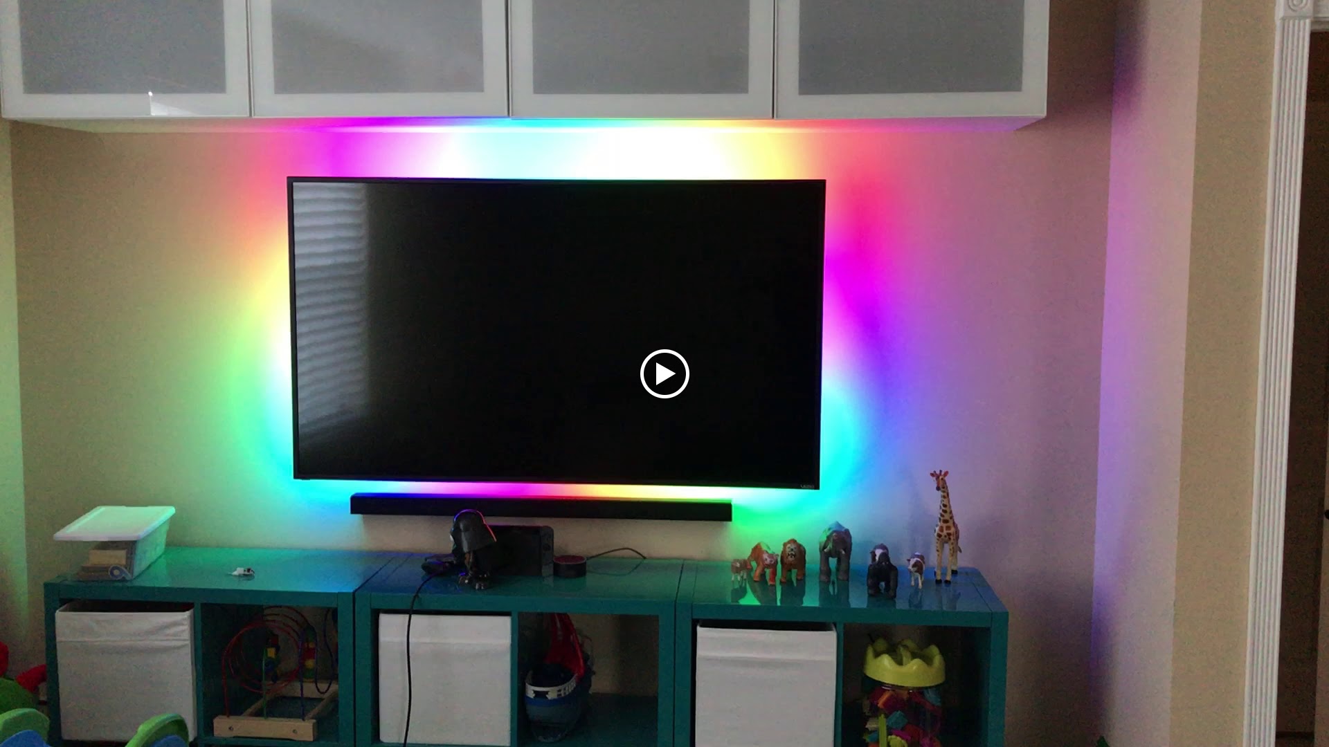

Hey there, got up and running with a nodemcu 1.0 board, 2811 light strip,
Hey there, got up and running with a nodemcu 1.0 board, 2811 light strip, and FastLED sketch from here: https://github.com/bruhautomation/ESP-MQTT-JSON-Digital-LEDs/blob/master/ESP_MQTT_Digital_LEDs/ESP_MQTT_Digital_LEDs.ino
So it all works great (well other then the connectors suck and I keep losing signal, another post about that later)
What I really would love some help with is something super simple. I want to be able to set a static colors for each of the corners as well the centers a different color as well. That’s it. I have 78 drivers each powering 3 pixels. I tried to figure it out but failed to understand the existing sketch very well.
I know what I want to do is super basic so I am hoping someone can get me started in the right direction. The overall idea is for example with 4th of July have a static layout of colors red, white, and blue. For game day have team colors, etc… I figured I would create each as a effect.
Thanks in advance and super awesome project you guys and gals have here!
