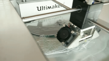

Wh is pictured in the animated GIF seems to be a bed adhesion problem due to the nozzle not being set close enough to the bed during calibration. Some people have beds that are not level or have warps in the bed. When people can’t/won’t fix whichever of those two issues, the sometimes set a thicker initital layer or they increase the initial layer extrusion. A 0.3mm initial layer when you print 0.2mm layer prints can be the result. Oh yeah…imperfect delta calibration or delta numbers can cause a need for such a work around too. Delta issues are also a pain to figure out.
