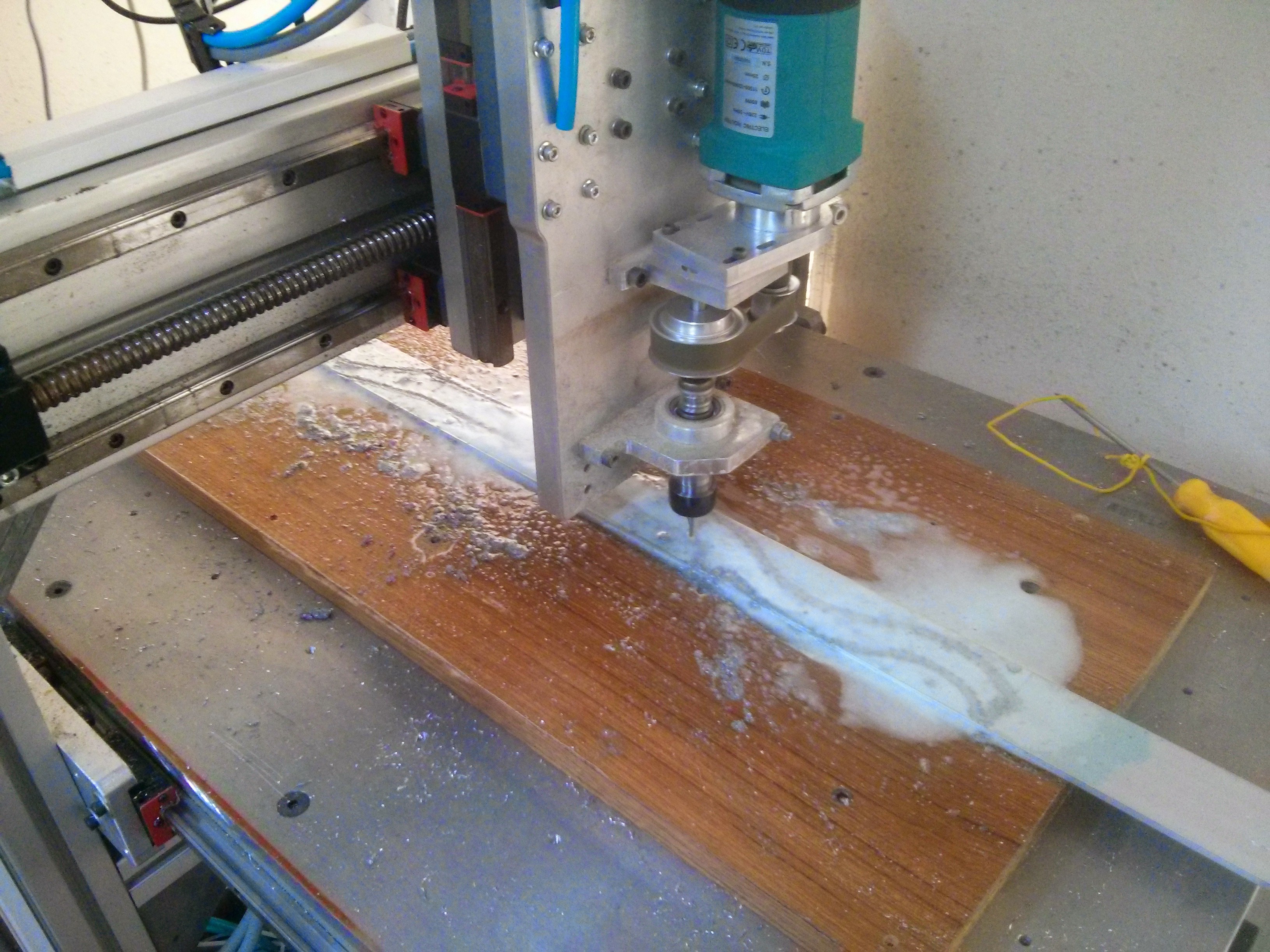

Hi again,
I got lots of progress from my last post. You already know I had some vibration problems but It is gone with lots of aligning. I bolted 15mm 6082 aluminium on my table. It made huge difference on rigidity.
And as you can see from the pictures I made a belt driven spindle from a cheap mold grinder (600w). I got lots of advantages with this system.
I can use 2 to 10mm bits, I doubled the torque and I reduced minimum rpm to 5500.
But it is LOUD.
I am saving money for water cooled spindle by the way
Comments and crits are welcome.
