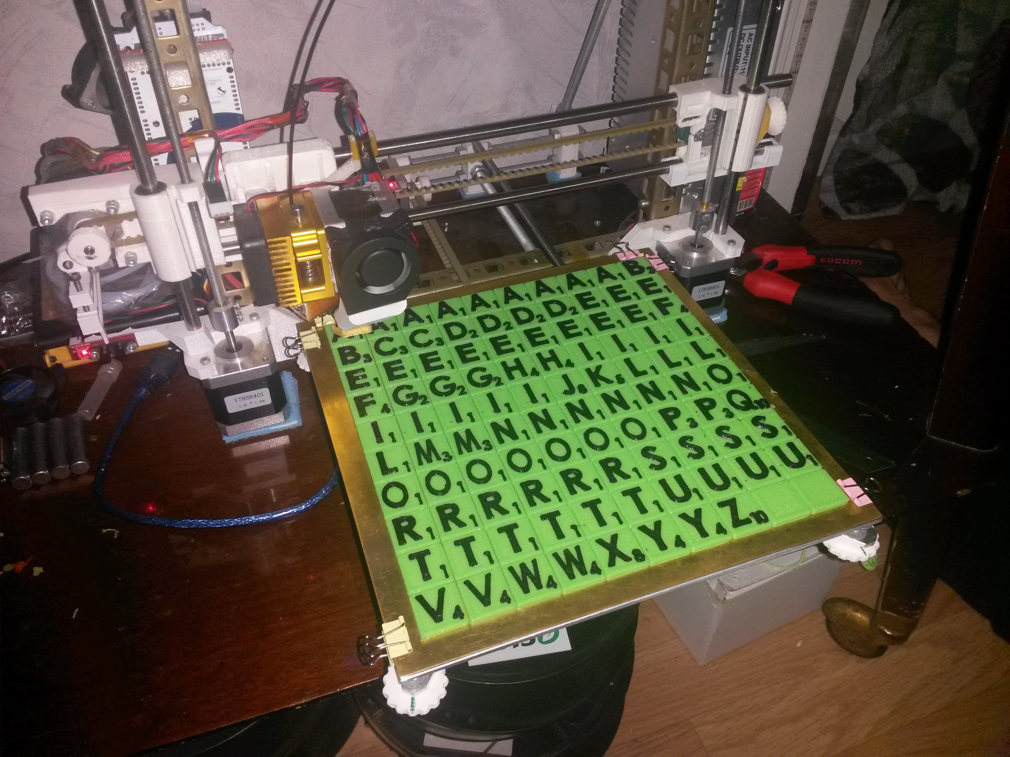

These are some pics from the tiles being printed and some showcasing the end result
What is that model 3d printer?
@John_Car well, it’s based on a pruse i3 design, but it’s all custom made - because that’s how it ends up working when the frame is built out of “whatever is available”
damn the bed looks huge what is the size ?
@Graydon_Treude that’s what she said! :stuck_out_tongue:
the bed itself is 219x219 mm^2 and the print area is 209x211mm^2 - I’m limited to 209 on the X axis st that’s truly all the space the carriage can move, i can go more on the Y axis tho’. I left it like that because the axes complement each other nicely
@Adrian_Ciubotariu thanks im stuck with 8x8 inch
@Graydon_Treude that’s why I went the custom way… you decide the size. do like i did with my old printer: design a new one, assemble it in any cad software and use as many pieces from the old one as possible (measure everything) and then tear yours down and rebuild the new one, the way you like it.
What is that bulldog clip holding? Seems like you are using aluminum bed.
@Step_Cia indeed I am using an aluminium bed BUT, on top of that i have a 0.75mm brass plate for super fast part removal. since it’s elastic I can flex it a bit and the parts just come off. another plus is taht it’s super easy to clean the glue off of it and it matches the printer “theme” too so my little ocd is kept in check :smiley:
a thin brass plate on top of aluminum. hmm interesting setup you have there
@Step_Cia ​ :)) thanks. And the clips are perfect to not get in the way of any print. So far, these tiles are the largest surface, single stl file I’ve done: 199x199mm²
Do you have any issue with flatness of such a thin brass plate? Particularly in the middle since you have it supported on all 4 corners but not in the middle…
@Step_Cia brass is quite strong. (elasticity not plasticity)… And when I am flexing it, it’s just for a couple of mm
