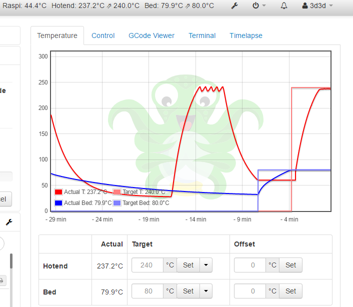

Now more information. When i put manualle example 240degrees evrything goes ok (like diagram last section shows). But when you start work with slic3r gcode, that every time do that what you see about center of diagram, setpoint leave couple degrees under and printing not ever start.
