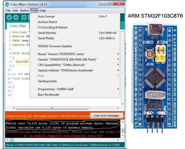

Why when I use FASTLED library (https://github.com/evq/FastLED/tree/stm32f103) in my skecth, program storage becomes very full when compiled. The program code is still very little.
I am using board STM32F103C8T6 and ARDUINO IDE.

Because this isn’t an STM board/configuration that’s supported or been tested (the spark ore and photon are the only ones that fall into that and they have something like 1MB of flash) - and so no size optimization work has been done.

The problem is the code size - and this board has a fraction of the code flash available as the other supported stm32 boards. I haven’t done any work to make the library’s arm code fit with such a small amount of flash, which is part of why the board isn’t supported by the library officially.
