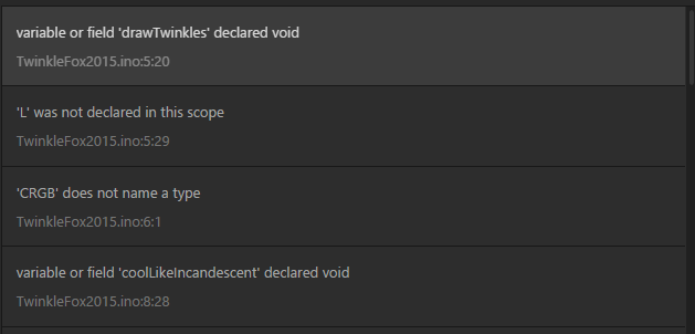

There are about 15 errors (hard to see in Particle Dev), and can’t cut and paste them, but here’s the top ones:
Do you think that’s it, and it just won’t work being 3.0.3?

There is no CRGBSet in this version. I miss it too. You’ll need to remove that and replace it with a homegrown function of your own. If you look at the latest, a simple function can do it. Pry won’t take very long.

Hi Jason - It would be great if you could do that. But I’d be happy if I just knew what I could replace “CRGBSet& L” with. Anything with a ‘&’ is a bit beyond my abilities! :frowning:
