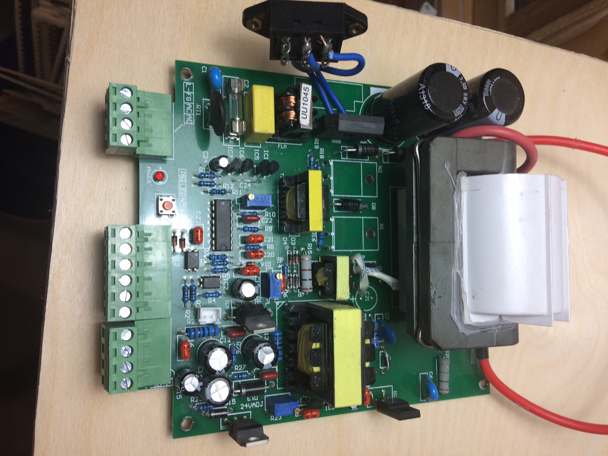

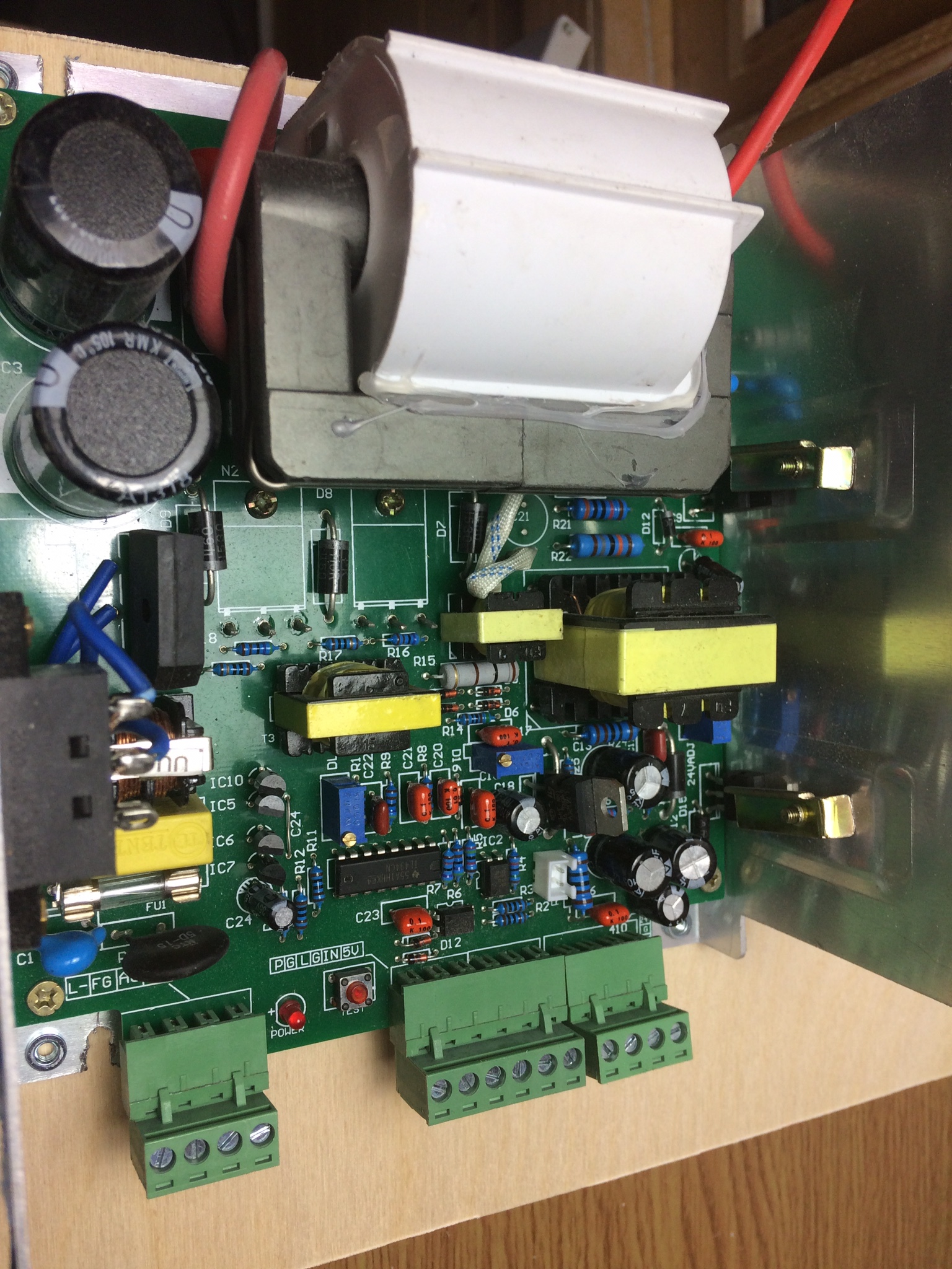

Can you take one of the supplies cover off and take pictures of the components. Look for something charred.
I will take some photos in the daylight tomorrow. I didn’t see any charred or swollen components but I did just check the internal fuse and have a quick glance over the rest of it

Just added a short vid of the tube, i have also noticed that when it happens the monitor on my pc blacks out. They are both on the same ring main but not on the same socket. I have also taken a few pics of the inside of the last psu that i will post shortly.
As you said nothing obviously failed from the picture.

Did you replace the drive transistors I.e. those on the back side of the board.

It’s strange the transistors are on the bottom and their solder connections looked a bit cold.
@donkjr The 24v section is fed to a 7812 regulator which turns it into 12v. This is fed to the driver ua494 chip which drives the hv section. If the 24v breaks every goes dead.
