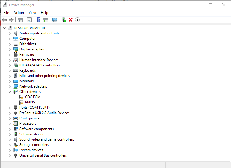

Oh a bit more info, I am having a driver issue as I have seen in another post. I am missing the CDC ECM and RNDIS drivers in my “Other devices” section of Device Manager. I have tried downloading the Acer version, and I have even tried using a driver finder tool that typically works great for other drivers. It does not work.
Screenshot of my Device Manager
Hi Chris, I would focus on getting the RNDIS interface working more than the CDC one. The BBB shows two network interfaces over USB, one is the RNDIS which is standard for Linux & Windows, and the other one is for Macs. The RNDIS should be a standard driver load, and I’m unclear why it’s not working.
I haven’t been able to figure it out either. I have tried my laptop, and my PC. PC running windows 10 pro and laptop running windows 10 home. Both are displaying the same issue with the RNDIS driver.
The best I have come to find is that windows 10 has problems with RNDIS driver support. I don’t know if that is still valid though. I can’t seem to find a fix that works for it.
agh! that’s a general beaglebone/windows issue though, not Umikaze specific. We build Umikaze based on the normal Beagleboard Ubuntu distros from RCN. If you google for normal BBB problems with network on windows any solution should apply here also. Sorry I can’t help more, I’m rarely seeing this problem myself as I work mostly on ubuntu.

I got a microHDMI cable now, and I am trying to flash the new 2.1.2rc3 but it only gets as far as preparing to flash and then it freezes at “Tearing Down script environment” unmounts /tmp and stops the cylon LEDs. Then it just sits there. No issues with the 2.1.1 when flashing. Going to try rc2 maybe.
I ended up kind of solving my problem. I reinstalled the 2.1.1 stable image, and I just rooted into the system and configured a new wireless connection on the device using nmtui and it works now. I can SSH through PuTTy and I can hit the http://kamikaze.local
Pain in the arse, but not umikaze fault. Thanks Microsoft.
