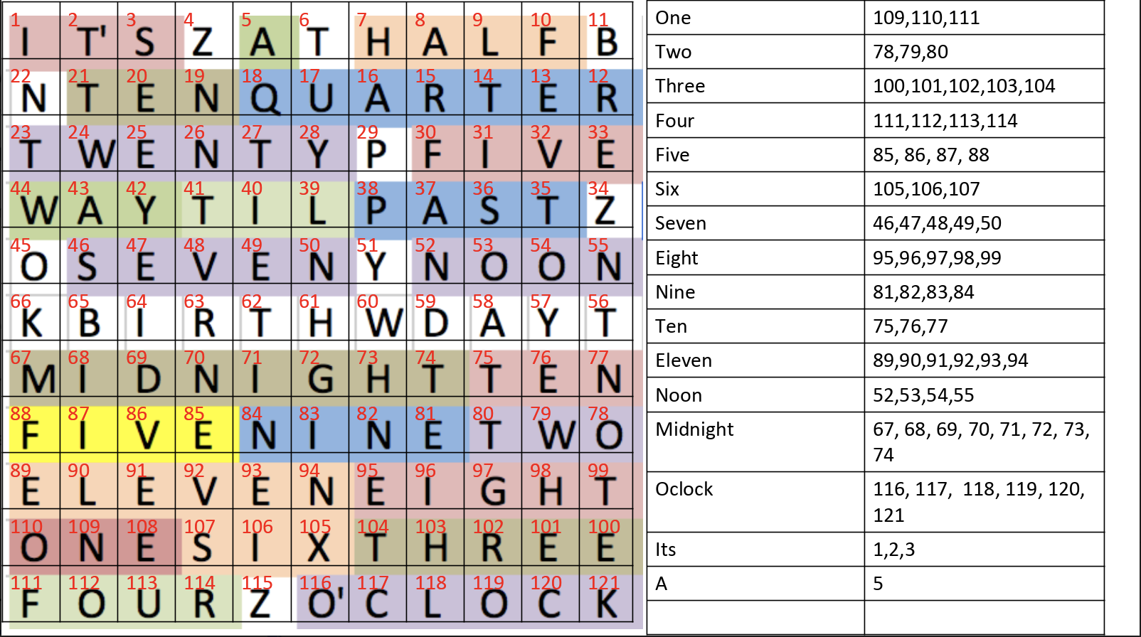

Hi All,
I am having some issues with the code for this word clock. I’m using an RTC breakout to tell the time, and a 121 LED long WS2812 strip snaked around as the picture shows (I started at 1 in the picture and realize that Arduino starts at 0, stupid MATLAB). I’ve written a loop for the minutes, and it works well for the most part - it reads the time from the clock, and outputs the correct LEDs. My problem is when it’s time to move to the next set of words, the previous set does not turn off. Any help is appreciated! Here is my code:
