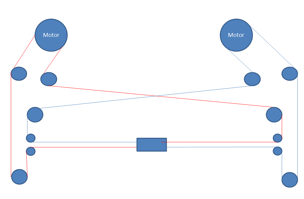

Hi all ,
I am planning to build a core xy gantry based 3d printer. I also want the belts to cross over at the back where the motors are placed
Do you think the below diagram will work ?

Hi all ,

Yes, that looks correct
best of luck!
Brook

Also wanted to know if the torque required for the motor will be higher since the number of idlers have increased.
Would the ramps 1.4 be able to handle this or do I need better stepper drivers like the TMC2130
Hussain.
My style is jump in and try what you have. So many variables and unknowns, so go for it. I think you will be fine and you can always upgrade.
both are working, but the second is the better.
@Jakab_Gipsz The first is actually a H-Bot and not CoreXY…
It is best to keep the belts parallel, btw
