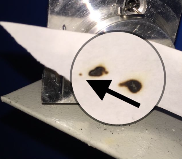

@David_Piercey @HalfNormal Hi So I already follow all the steps try to move the second mirror so that it aligns perfect when I move it to front. Here is the image when I move it back and front its the movement of the arrow. I don’t know why the laser beam don’t gets to the third mirror. The arrow shows the movement from first to second tryout.
Do not give up, it can take hours to get it right. Read all the alignment guides to get an idea of what you are up against. Sometimes you have to move the whole mount not just the screws. It is critical that you adjust everything in the order that is recommended or you will just chase your tail. You might need to adjust the laser tube as well. Remember these were made to work in a narrow area and not the whole bed.

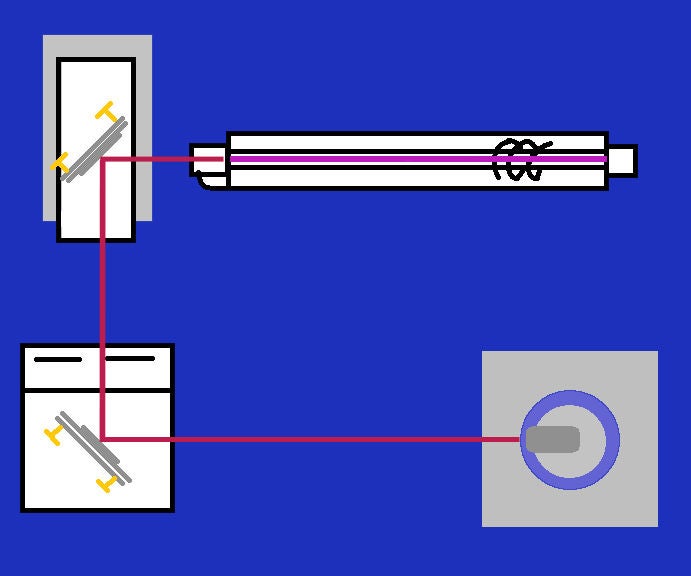

Visual picture of your problem, if i understood it correct.
The beam is not paralell, you need to move 2nd mirror plate to straighten it. Always re-center the beam in furthest position before you test-fire, if not you get old error + new movement as total error.
