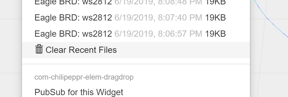

I am using the jpadie workspace and am about to rip my hair out. For whatever reason, it is not updating the files. I had a file earlier that I realized prior to milling that it had a mistake. I re-exported the nc file, then dragged it into CP. The visual is correct for the new file, but the head is traveling to places unknown. It looks like it’s trying to mill what was in the old file. So, now I have a hole in the middle of my pretty aluminum box. I have “cleared recent files” so all that is in there are my new files, again, I can see the image change as if it’s received the new file, but it continues to try to mill the old location. I even tried to break the file into smaller parts (each op in it’s own file). But again it’s trying to mill the one from an hour ago. Any ideas on how to get passed this?

I think the crux of the problem is when your localstorage fills up, which only allows 5MB due to browser limitations. ChiliPeppr stores all of your recently uploaded files in localstorage, so it can get filled up. Then, when you drop a new file, including from Eagle Brd widget, it gets sent to the 3D viewer first and then to other widgets, but something must happen at that step where the Gcode widget fails to load it.
The solution would be to wipe out your localstorage which you can do in the File menu.
