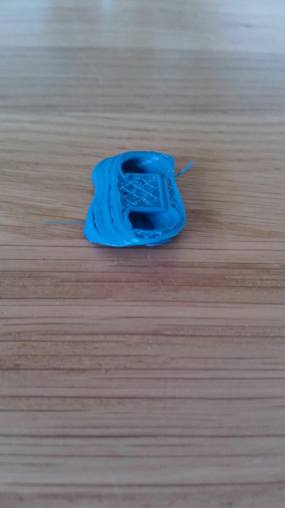

Update time. Thanks for the suggestions which has finally let me to the direction if the x axis was wrong but I found, with my dad’s help, that the end stop was working but the wrong direction. So I updated marlin to invert the x axis which has fixed this particular problem. Now to resolve my original issue of the slipping x axis layers as shown.
