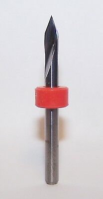

the current engraving bit I am using is this one and I am using cambam as my cam software.
