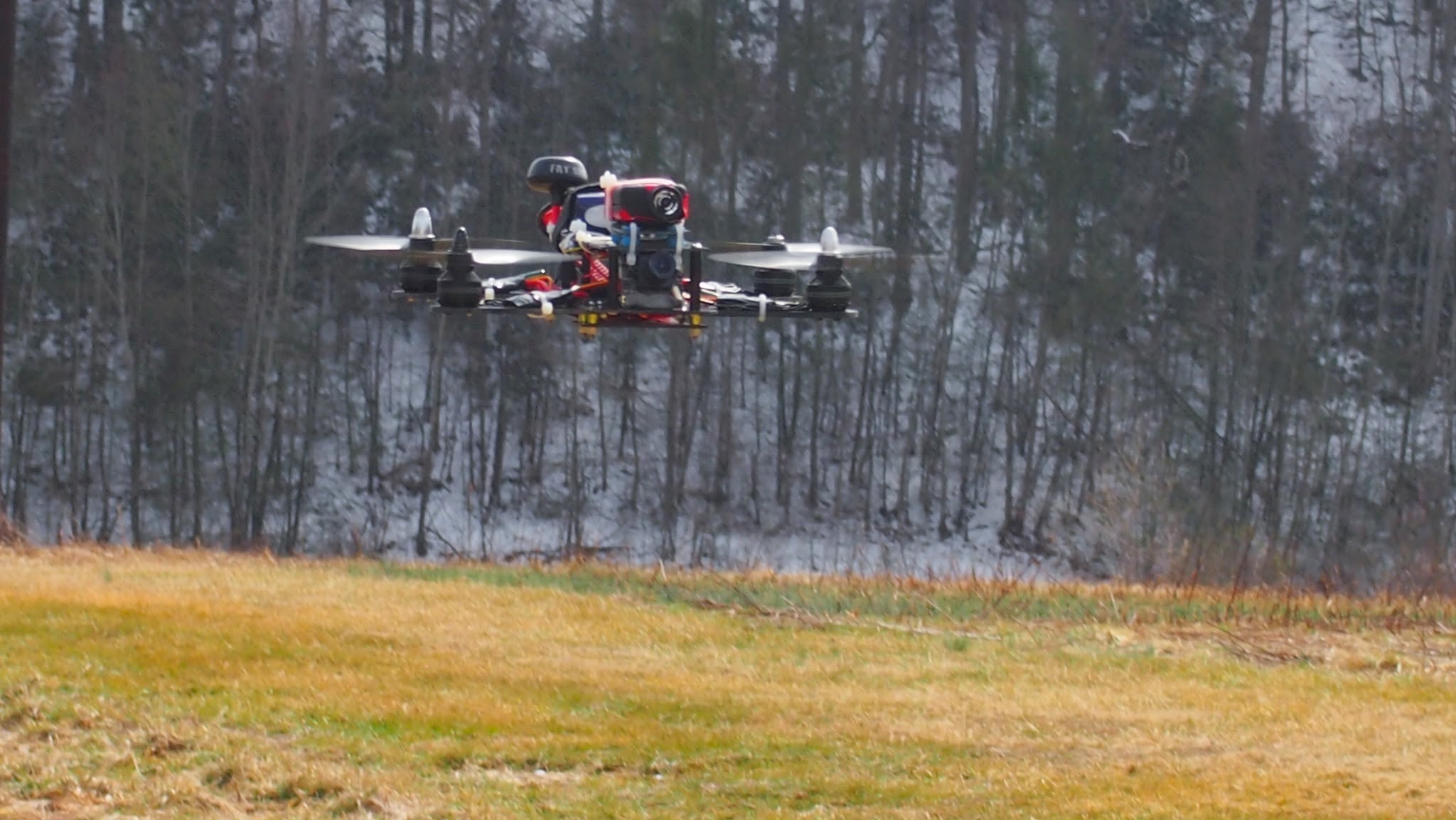

this is what I will be cutting. Any advice?
Be careful cutting carbon fiber its nasty stuff to cut (you really dont want to breath the dust in). Make sure you do some research before you start cutting.
yes I know I did research before cutting the prototype out and I got special masks and do it outside. I am going to try to rig some kind of vacuum system up to the cnc also.
