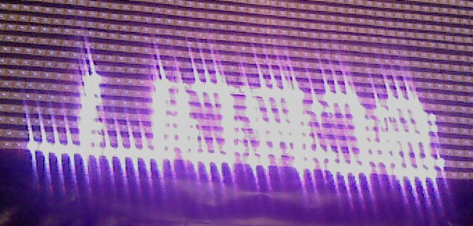

Hi all,
I try to use LEDText but my text “SCROLL LEFT” is scrolling right …
Anyone who knows how to change Text and Scroll direction?
I did try leds.HorizontalMirror(); but could not see any effect
Sorry for the bad Image

You’re referring to @Aaron_Liddiment 's add on text class correct?
It might help if you can post your code to http://pastebin.com
And how did you layout your matrix? Is it wired in a serpentine or zig-zag fashion?
I imagine your matrix is wired with the first LED in the bottom right? If this is the case you need to invert the X axis by putting a minus sign (-) before the Width value in the cLEDMatrix definition.
The LED’s are wired in horizontal zig-zag fashion. I use the TextExample1 from Aaron. And adapted only my MATRIX_WIDTH 60 and MATRIX_HEIGHT 25.
@Aaron_Liddiment It could be wired also top left but then the text is upside down. gonna try the (-) sign. Thank you!
In a similar manner if your first LED is top left you could put a minus (-) sign before the Height value in the cLEDMatrix definition to invert the Y axis.
Basically the minus sign will invert the relevant axis so that you can always keep the bottom left corner as 0,0 however your matrix is wired.
