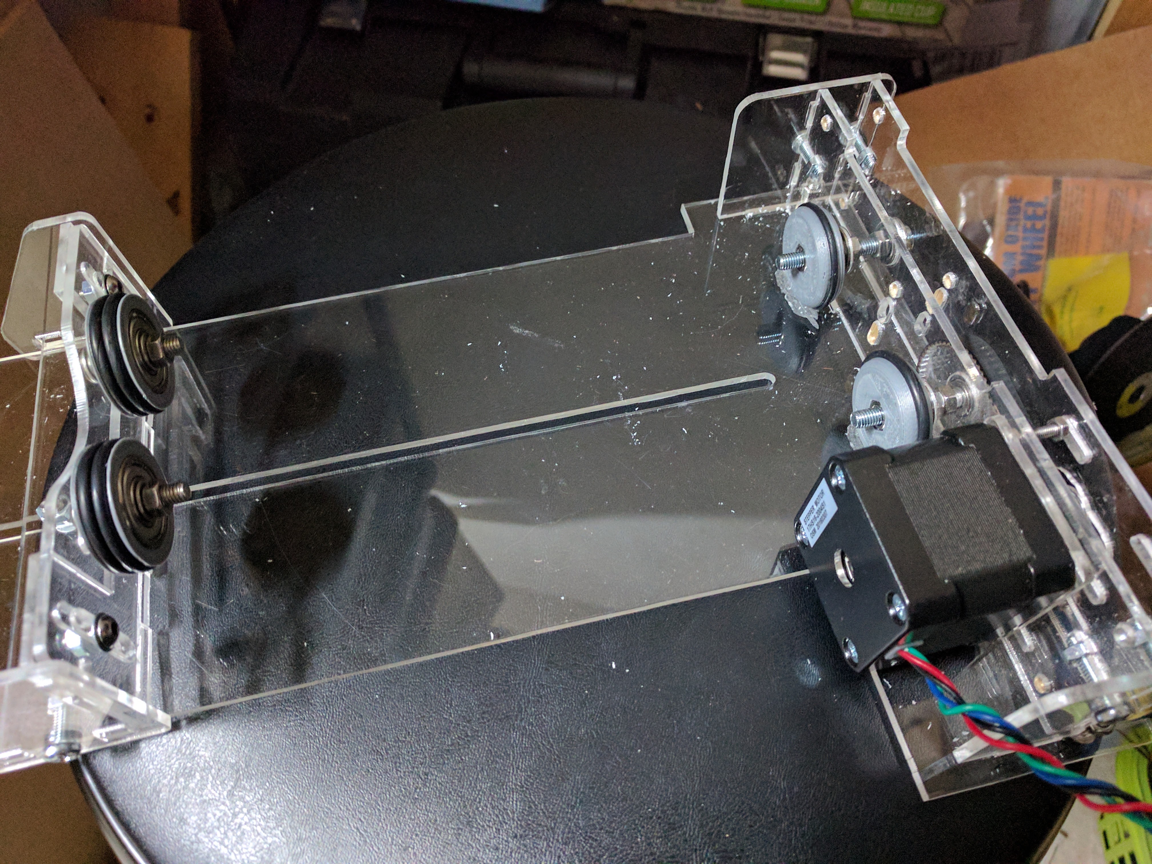

Hi all. I’m almost done building the rotary found here https://www.thingiverse.com/thing:1359528. One hurdle that I can’t seem to get past is how to adjust for focal distance. This design is height adjustable only on the ass end, but the driven side is not height adjustable. I am thinking I can make only one wheel drivable by the stepper motor and the other wheel adjustable left to right to raise or lower the work, but that doesn’t solve my problem completely as I don’t think it will give me enough adjustment. I’d love to hear your thoughts and suggestions. I could also shim the bottom to raise or lower the whole rotary assembly, but that would be a pain. Thanks in advance for any input!
I just raise/lower with several pieces 1/4" ply until focal length is correct. One day I’ll make a adjustable bed.
Shim it. The adjustable end is for wine glasses and similar
Thanks guys. I figured that might be the easiest solution.
one side is adjustable to account for the odd bottles, etc. I would assume if you set it level on your bed then it should be fine. Coincidentally I also have made this, how’d your build go with only those photos to go off of? I took some liberties tweaking the drive train myself. I’ll post a pic in a few.
@Domm434 My build is going ok. I had to change some parts due to alignment issues as pointed out by @Ariel_Yahni_UniKpty . I ended up changing the bearing features to fit bearings I have as well as lower the height of the bearings/drive wheels to maximize the size of bottle I can fit on it with correct focal length. I am still working on it, but it is mostly done. 3D printed different drive wheels also. The laser cut ones seemed more of a pain. I will post pics when I am done, but it may not be fore a couple weeks as I just got bad news that my dad has cancer. Looking forward to your pic.
ouch, sorry to hear that. Lost my mom to lymphoma 3 years ago myself so I get it. I used the same wheels that were in the print but had to tweak an end cap as the tabs didnt line up. got it to rotate with LW but im not fully confident with the reliability of those wheels atm as they are mostly friction fit(very snugly)
