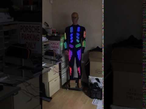

It is a waterproof LED suit I have made for a friend with a FlyBoard. (https://tinyurl.com/y86eo67u)
It consists of 8 different length strips of WS2813 LED connected to a teensy 3.2, using an OctoWS2811 adapter board. The suit contains 4 main sections (Arms, Legs, Chest & Back) with two sections in each (left & right) - each contains a different length of LEDs (Arms - 76, Chest - 86, Legs - 91).
So I have two strings of 76, two strings of 86 and two strings of 91.
(Plus two strings for the back which i havn’t managed to complete yet)

The last thing i have tried was to create a matrix with the XYmapping tool kindly shared amongst this community. I first made a matrix for just the right side chest and ran code from the RGBShades Demo mentioned here a few days ago. This is what i achieved with that - XYmapping One Section - YouTube
However, when i create a matrix that contains the whole front of the suit i.e The legs, arms and chest (image #3) and output using only one pin with the RGBShades demo for reference, the frame rate drops to 5fps @ 48MHz and 9fps at 144MHz. i know this is not a reasonable test to try and output approx 1900 LEDs on one pin(The matrix needed to be 26high x 73wide to contain the pattern of LEDs - this may have to be even be larger in the future to more accurately define the complex LED layout) but then i remembered my earlier testing with parallelOutput, from which i was getting frame rates of approx 140-150fps.
