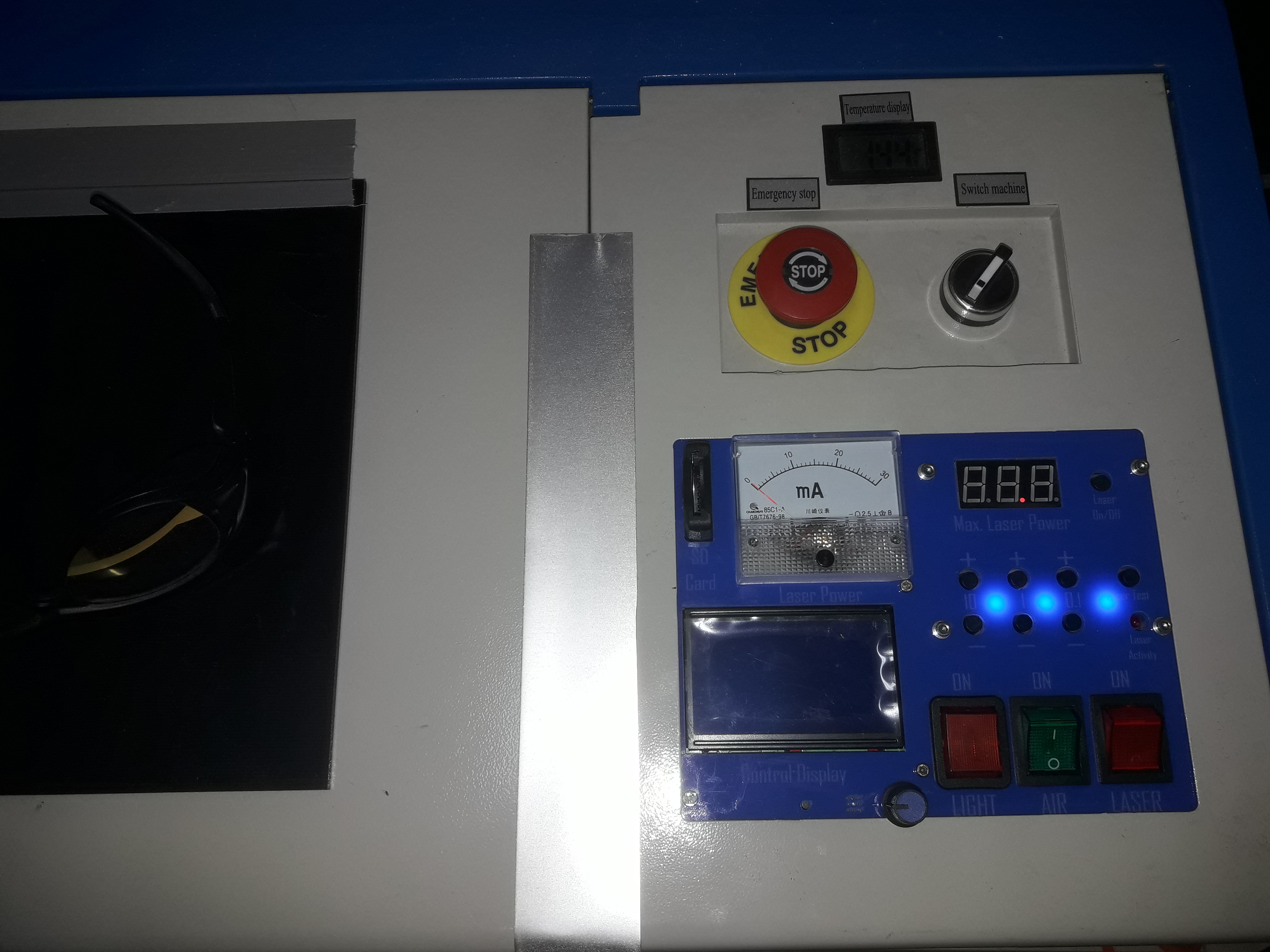

I’m getting an issue with my K40 (the one with digital panel) with a Cohesion board and other mods.
This morning when engraving as usual, suddenly the machine stops engraving, but movement was ok.
I made some test, start running a engrave test at very low power and slowly increasing the power setting.
At low settings (ampmeter reads 3 - 4 mA) laser was firing fine, but when I increase the power, there is a moment that it stops firing, and output current drops to 2mA and the lase was not firing at all.
Any idea of what could be wrong, tube or power supply?
Are ther any other tests that I could do to identify the problem?
Thanks and regards.
