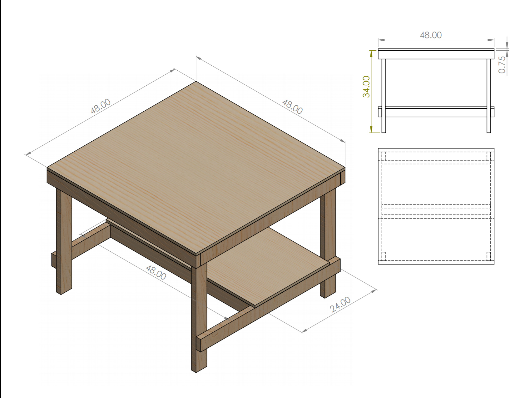

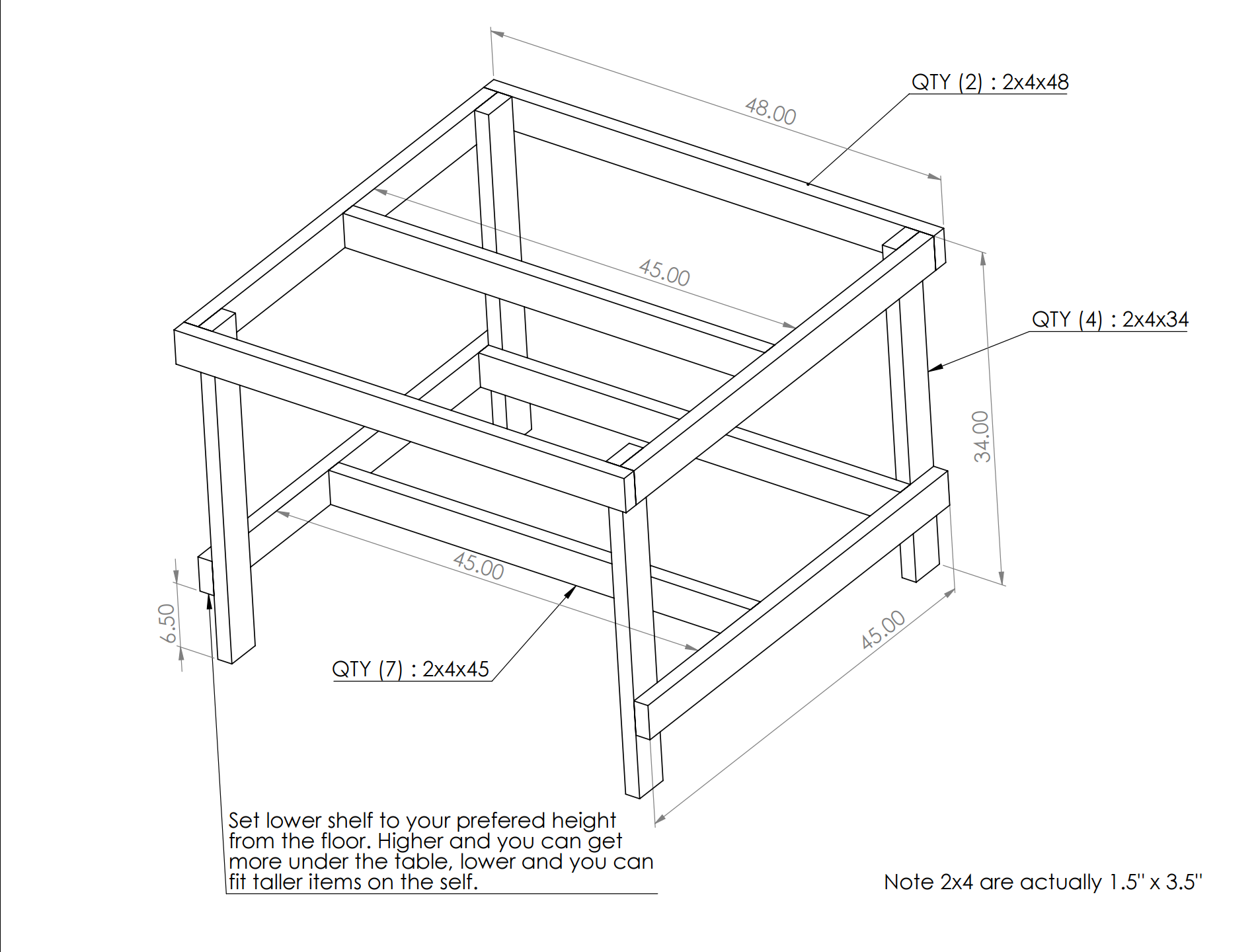

Here is my table:
It can be slightly smaller, but not a bunch smaller. I have a top view model of the exact dimensions of the unit somewhere… But right now I only have my phone with me.

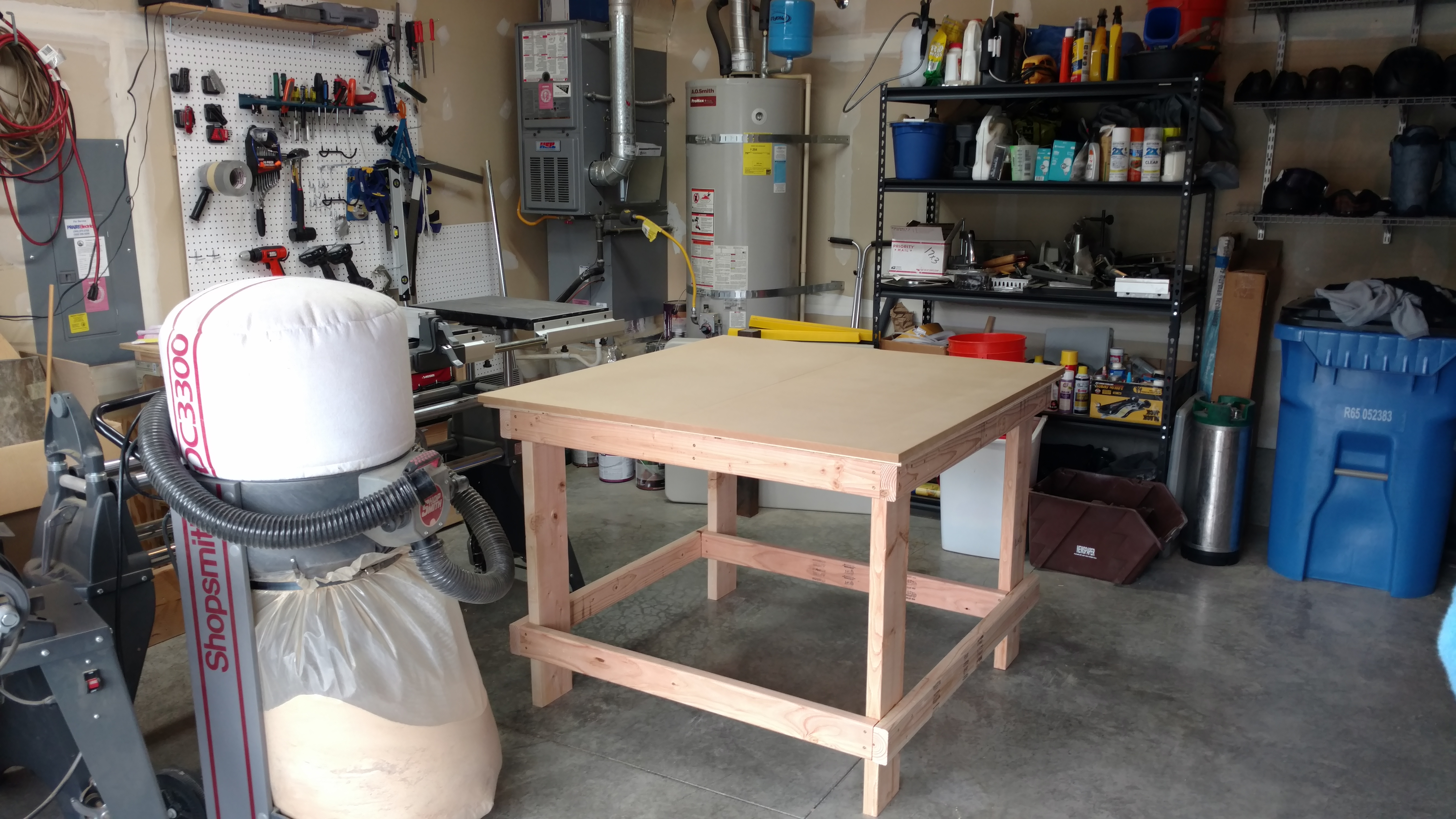

This is pretty much what I envisioned making, thanks!
I’ve got it on a 4x4 and that’s about minimum. I have about 3 inches on each side to spare
I’ve seen a lot of people mounting theirs on a various versions of torsion boxes. Since the R7 is mounted directly to the spoiler board, a lot of it’s strength comes from the mounting. Make sure it’s level and doesn’t flex too much.

CnC bench is complete, time to assemble the new machine!
