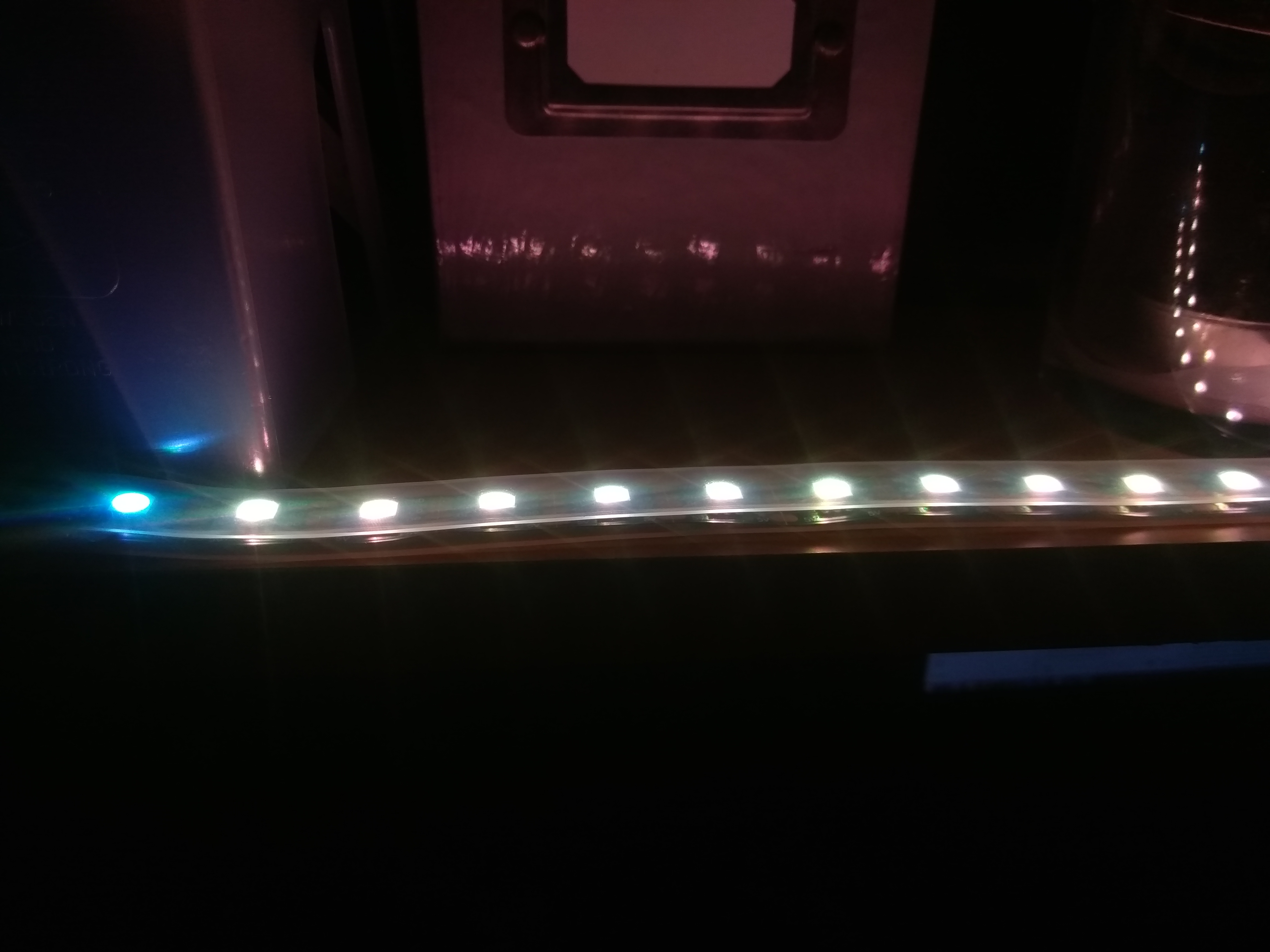

I’m having an issue with an APA102 strip, and would be very grateful for any help.
I have set all the LEDs to ‘Grey’, displaying them with FastLED.show() once all colours are set, however all the LEDs except the first glow the same colour.
When using .show() after setting each LED, all the LEDs except the first become more yellow as more LEDs light up.
I am using FastLED version 3.001.003, and I am controlling and powering the strip with an Arduino Mega2560.
Code is here: https://gist.github.com/z-0/3284e1ae04ce94eb43b1252ecb0412d9
The colour in the photo is not quite right as the camera I used does not accurately capture colour, but you can see what the issue is.
Many thanks!

@Jeremy_Spencer Thanks for the response. Unfortunately setting the data speed to any of those values does not fix the issue, nor does declaring them as SK9822s, even in combination with the data speed change.
Update: the first LED works correctly when the strip is powered from both ends. The colour changing issue is lessened as the overall brightness of the strip is decreased with FastLED.setBrightness.
