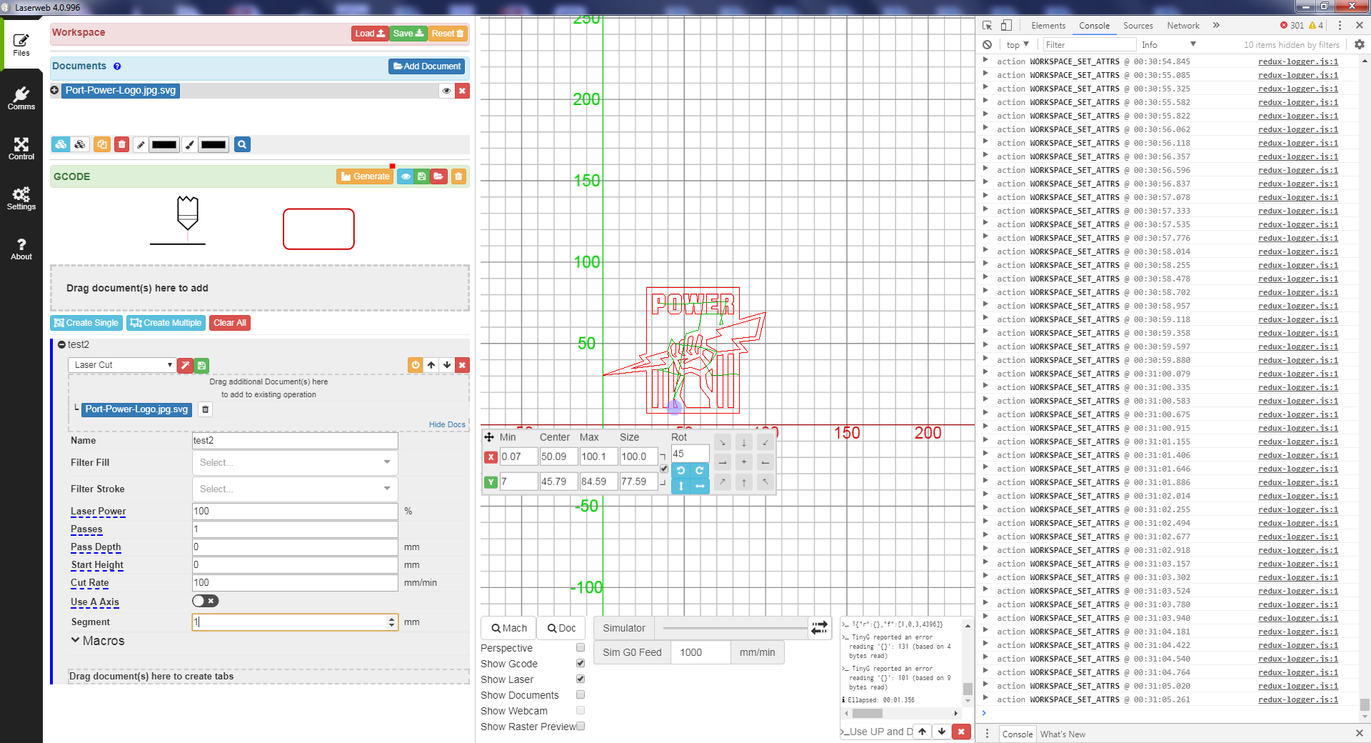

I’m running a ox cnc with chillipeppr spjs and cambam at the moment and all works good. I am attempting to get laserweb4 communicating nicely, I have some difficulty when connecting to the lw.comm-server component on the raspberry pi 3
I can connect and jog etc., I have run a raster job successfully but when running some jobs the lw.com-server stops on the raspberry pi shortly after starting the job.
I have searched for a solution elsewhere and was hoping someone on this group might have some experience with laserweb4.
output fromm lw.comm-server is
Run Job (319720)
undefined:1
{“r”:{},“f”:[1,0,3,4396]}
SyntaxError: Unexpected token in JSON at position 13
at Object.parse (native)
at SerialPort. (/home/pi/lw.comm-server/server.js:672:45)
at emitOne (events.js:96:13)
at SerialPort.emit (events.js:188:7)
at /home/pi/lw.comm-server/node_modules/serialport/lib/parsers.js:24:17
at Array.forEach (native)
at SerialPort. (/home/pi/lw.comm-server/node_modules/serialport/lib/parsers.js:23:13)
at SerialPort._emitData (/home/pi/lw.comm-server/node_modules/serialport/lib/serialport.js:313:18)
at SerialPort. (/home/pi/lw.comm-server/node_modules/serialport/lib/serialport.js:293:14)
at SerialPort. (/home/pi/lw.comm-server/node_modules/serialport/lib/serialport.js:306:7)
