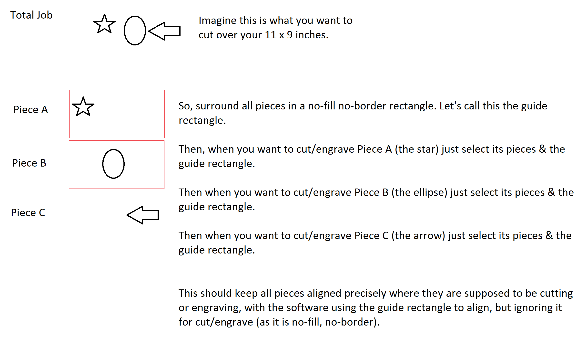

I would suggest creating a no-border no-fill rectangle around each section. All refer off the top-left.
