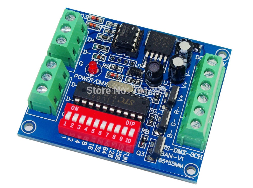

These are the only separate controllers that I know of. They’re RGB but you could put different sets of white LEDs on each channel. You can also daisy chain them.
http://www.ebay.co.uk/itm/272682254000
Actually now that you mention those @Jeremy_Spencer , it reminded me that I used some of these DMX voltage controllers a long time ago to control simple 12V strips and they worked fine. (Although I think the D+ and D- labels might have been reversed.)
@Harm_Aarts , if you want to control with DMX instead of an Arduino based controller, give something like that a try. You can find them on Ebay or Amazon too. Just be aware of how many Amps each channel can output and split your LED strips up as need.
