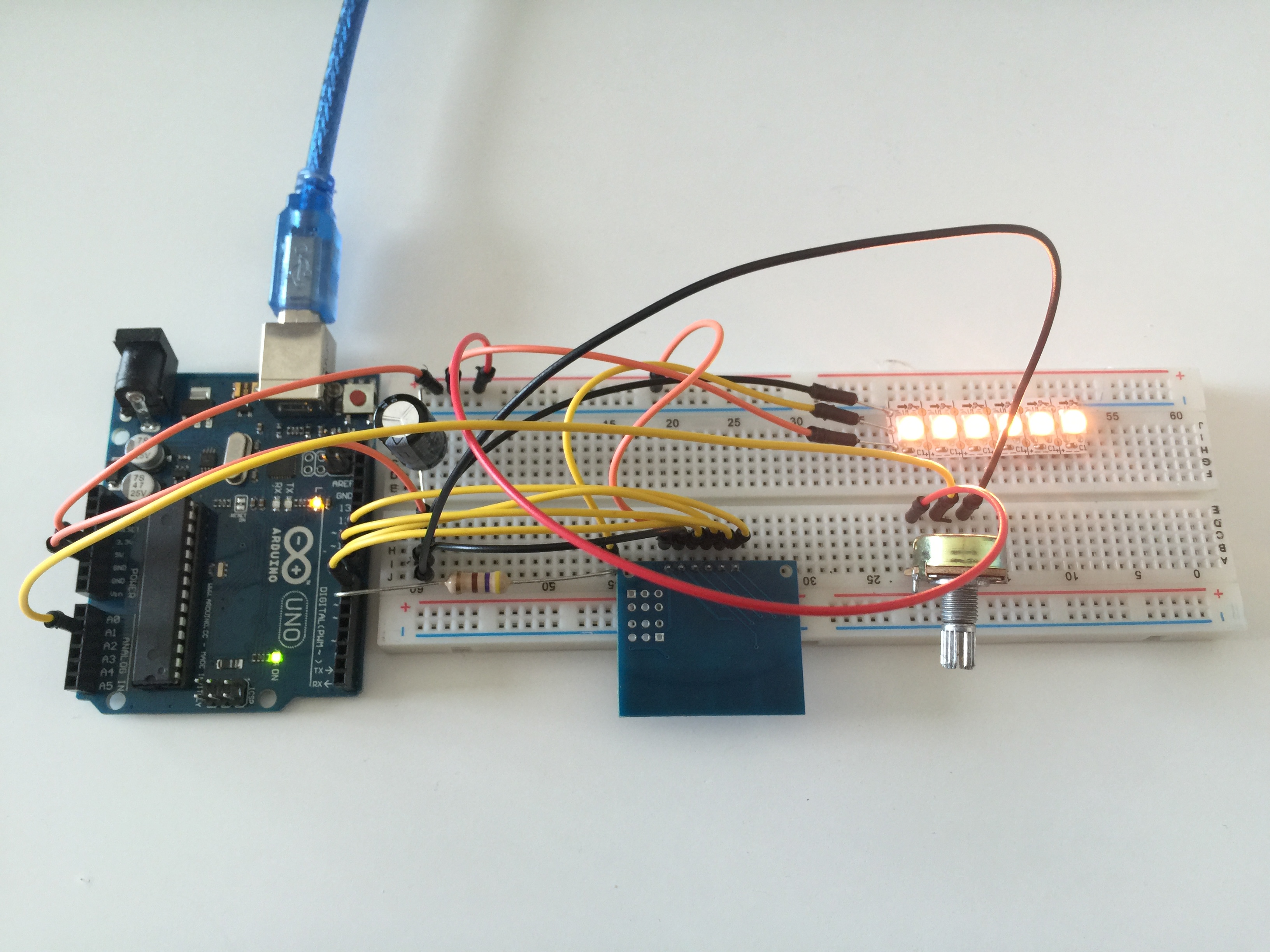

Hi all, I've been enjoying playing with my first Uno and some SK6812WWA LED
Hi all, I’ve been enjoying playing with my first Uno and some SK6812WWA LED strips. I’ve been using the FastLED library and defining/controlling them like the RGB WS2821B seems to work fine, but I have a few basic questions-
Using CHSV instead of CRGB I’m trying to control both the H (hue) and the S (Saturation), so I can adjust colour and brightness. I have part of it working but could really benefit from some expert advice :slight_smile:
