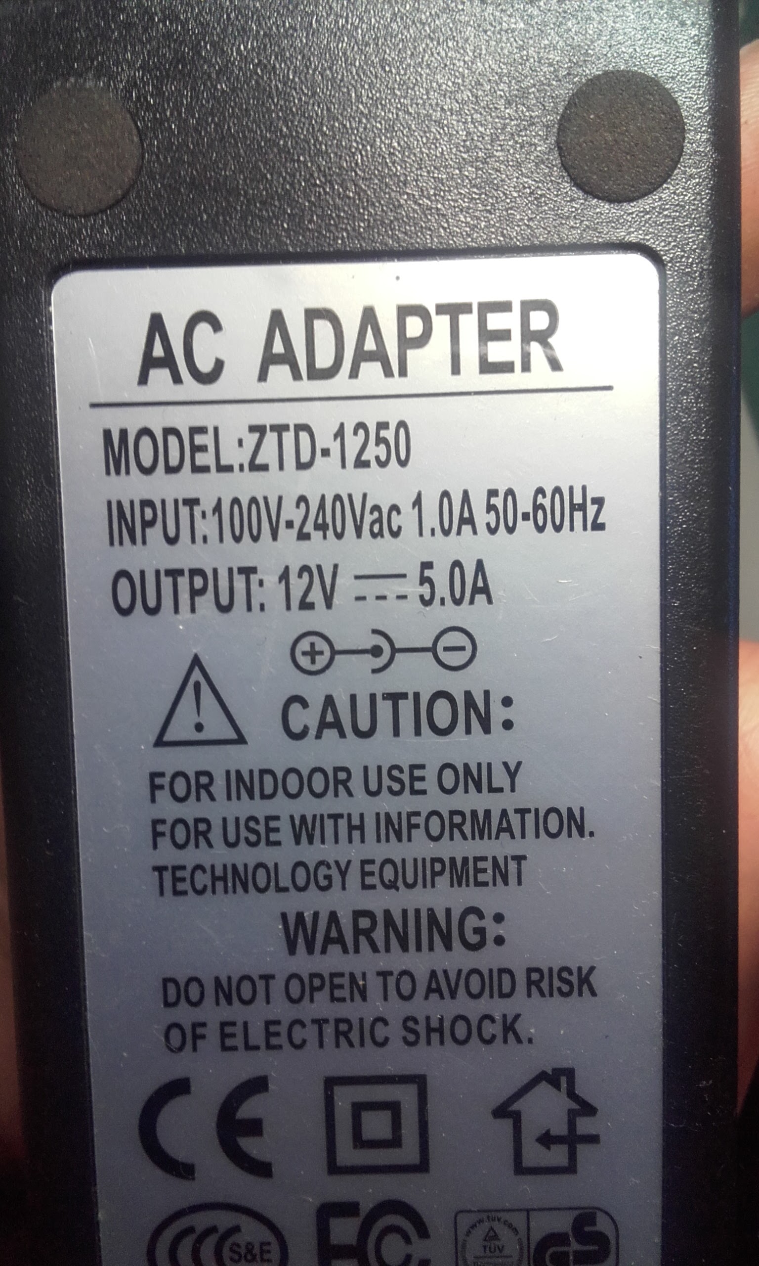

Just one more thing, regarding the power source for the IMAX B6, all I need is a cable that can deliver 12V right? Cause I’m looking at the head needed for the power source and I feel like I have a few wires that can fit that. Or do I need to buy it separately? I saw some that came with power bricks and all and I’m not sure if that’s needed cause it looked kind of overkill to me.
Don’t worry by the questions
What I don’t understand is why you need the cable. When you buy the IMAX there is a cable to connect to the plug (220V). This is what the IMAX needs:
Tell me if that is what you need
@Jose_Vh Oh really? Did you get it from HK or your local store? The ones currently available on HK doesn’t come with the power source
While those that do come with US plug instead which isn’t compatible with where I live.
Now I understand everything. I didn’t know that there was the option to buy the IMAX without the power source. Don’t worry, the photo I posted yesterday is the power source that came with my IMAX B6. I think that it is easy to find because is a very common power source.
Tell me if you need more photos or something!
