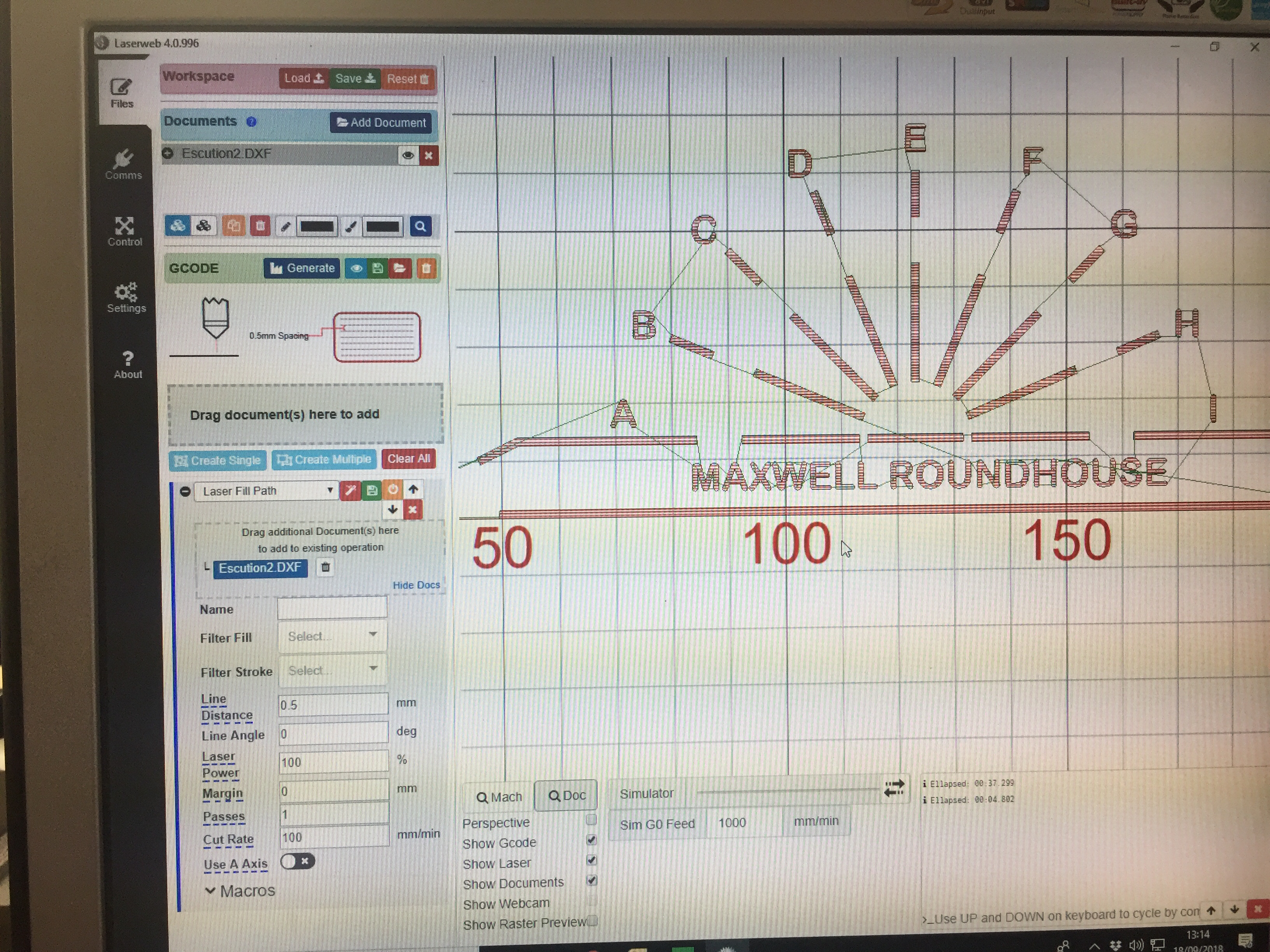

Hi All
Laser fill path…The option is made available when I load a DXF. I have tried a variety of settings and still cannot get it to work. I am using R12 DXF with 0.1mm Line Distance, 0 Margin, 500 Feed Rate and 100% power. Laser Cut produces usable code but there is no result for LFP. Laserweb version 4.0.996
I can see that others have used this setting but I cannot duplicate their results… Help please.

I have tried all available save settings in Solidworks 2012 and the best I can get is the round holes coding, the text and rectangles just will not code, I have even created a drawing from the model and it also was rejected. It maybe that there is something specific in SW12 DXF format that is not compatible with some options as Laser cut works perfectly even Laser raster merge gives me a line cutting code in Raster, but Laser Fill Path, Laser Cut Inside and Outside do not work for me. Any thoughts

SOLVED===
OK, SW12 will not produce a usable DXF for Laser Fill Path, but there is a way to modify the DXF thru DRAFTSIGHT, I used 2017 SP1 version.
1/. Open Draftsight and open the DXF…obviously.
(click any entity and only it will highlight)
2/. At the very bottom, LH side, type PEDIT and enter.
3/. Type M (uppercase) enter.
4/. Select all the entities to be converted, enter.
5/. Type Y for yes, enter.
6/. Type J for join, enter
7/. Enter 0 for the gap tolerance, enter.
8/. Press ESC to exit command line.
If you now select any entity you will see that it includes all attached entities, the drawing now contains ALL closed polylines.
Save the file as R12 ASCII Drawing(*.dxf) important.
Now load this file into LaserWeb and it will work with Laser Fill Path.
