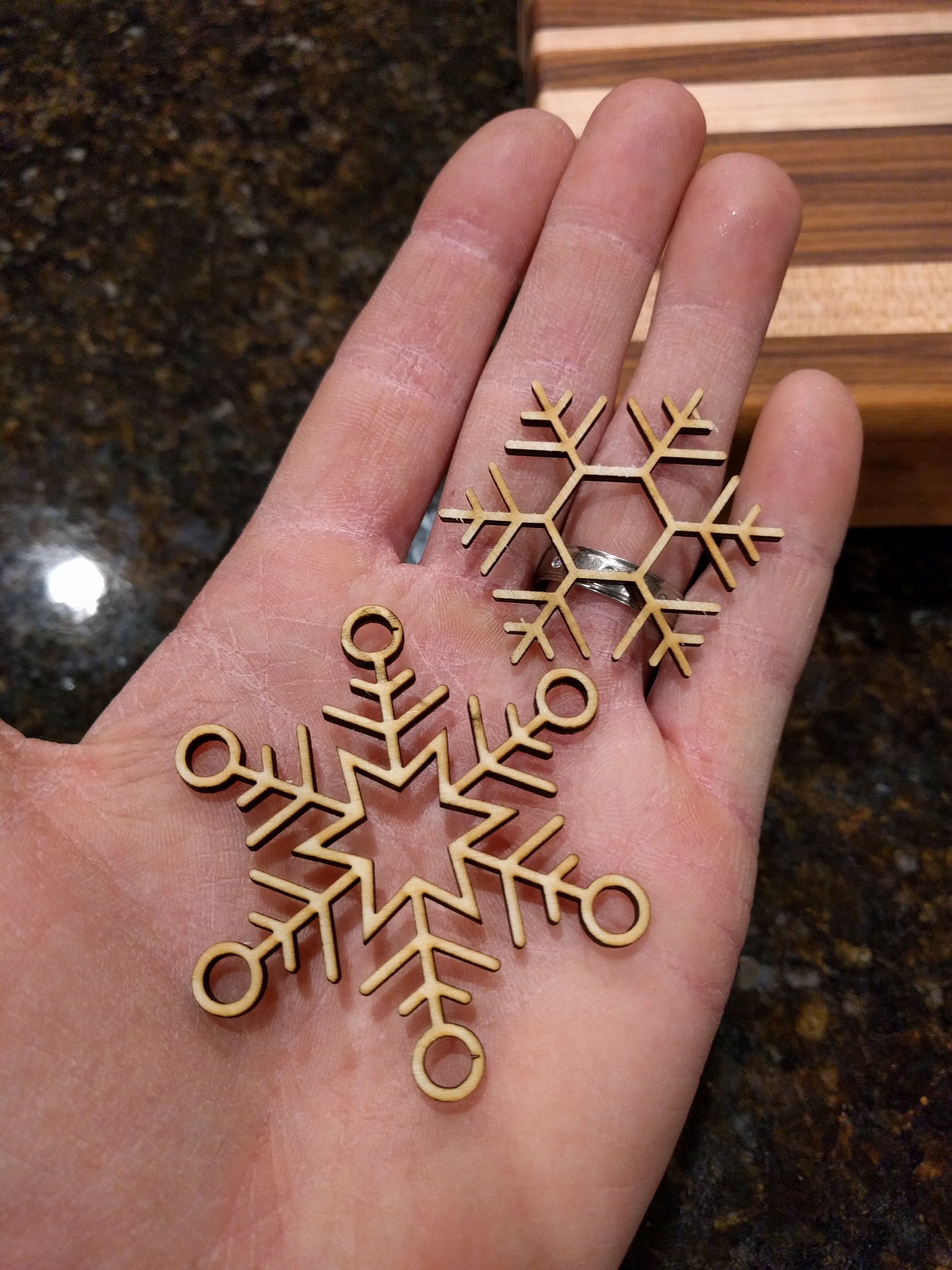

+Peter van der Walt, Interesting to say the least! @Sonny_Jeon Awesome thank you for looking into this! I installed a new Uno and did decrease the pull off distance(10mm) and changed the parameters I mentioned earlier and all is working still. Anyways, because it is working I was able to cut some seasonal snowflakes with LW. Thank you all!
Thanks. Had to do 5 passes for 3mm plywood but it worked great.
@Arion_McCartney Looks great!
