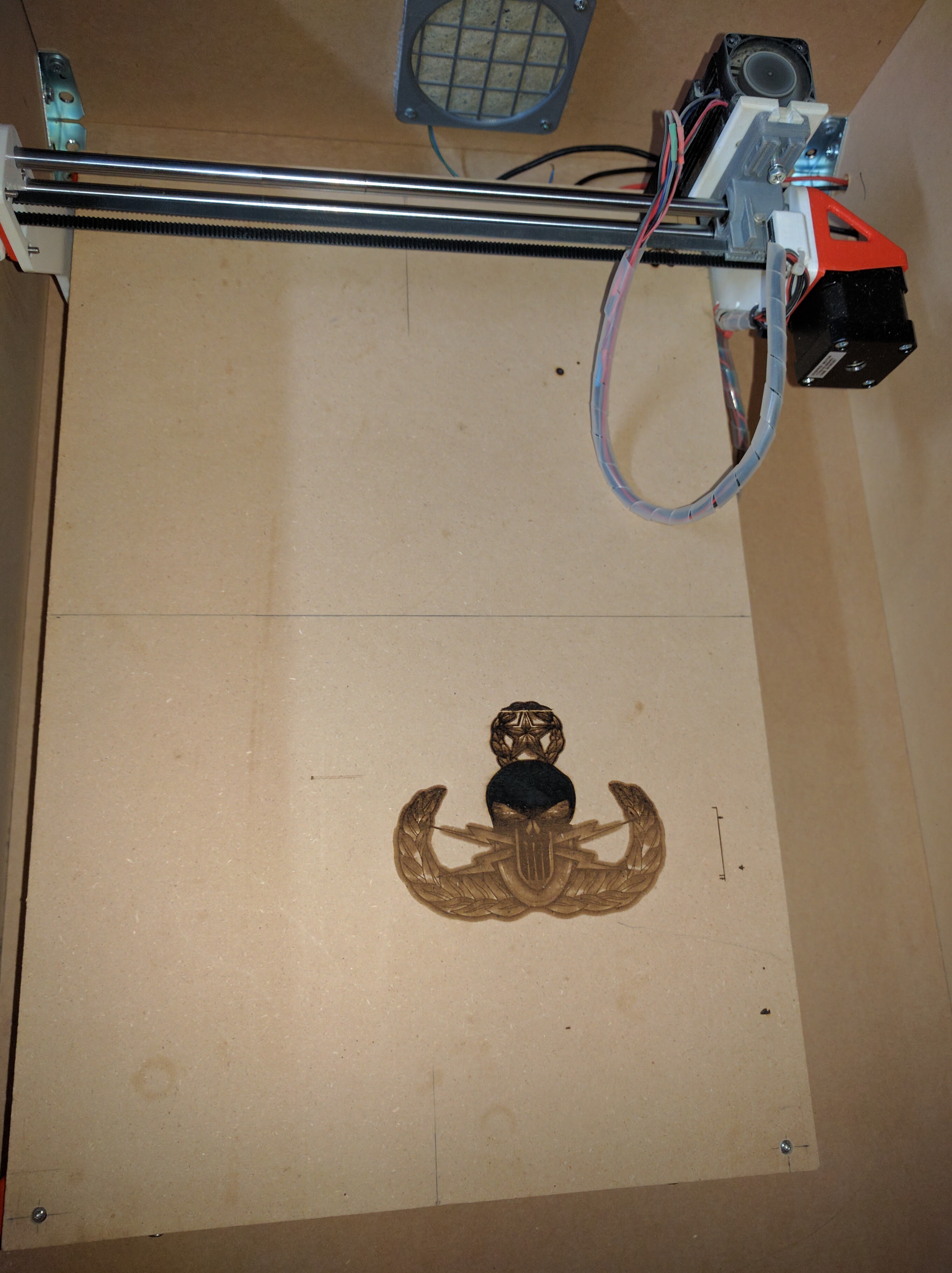

Hi all. My first post here. I came across LW while searching for a solution to cut and raster engrave using one software solution. I built a laser engraver from the 3dpBurner engraver design. I have a 3.5w 245nm laser that runs on GRBL. I’ve upgraded and configured GRBL 1.1e for my setup. I am really digging LW3. It seems to be the perfect solution for my needs. Thanks to the developers!!! And I see here that LW4 is in the works. I’m pretty excited about finding LW. I have one issue that maybe someone can help me with. LW works great as long as I don’t home the machine twice. If I try to home more than once, GRBL seems to lock up and won’t respond to anything unless I disconnect and reconnect. I’ve tried sending the unlock command and home commands via the terminal, but GRBL just does nothing. There’s no alarm or error code that GRBL sends when this happens. Only after the very first home I get an alarm 6, which doesn’t really make sense to me. Maybe I have a firmware setting screwed up? It will engrave fine as long as I send the gcode after the first home. I appreciate any help! Thank you. I attached a photo of my machine for no good reason
