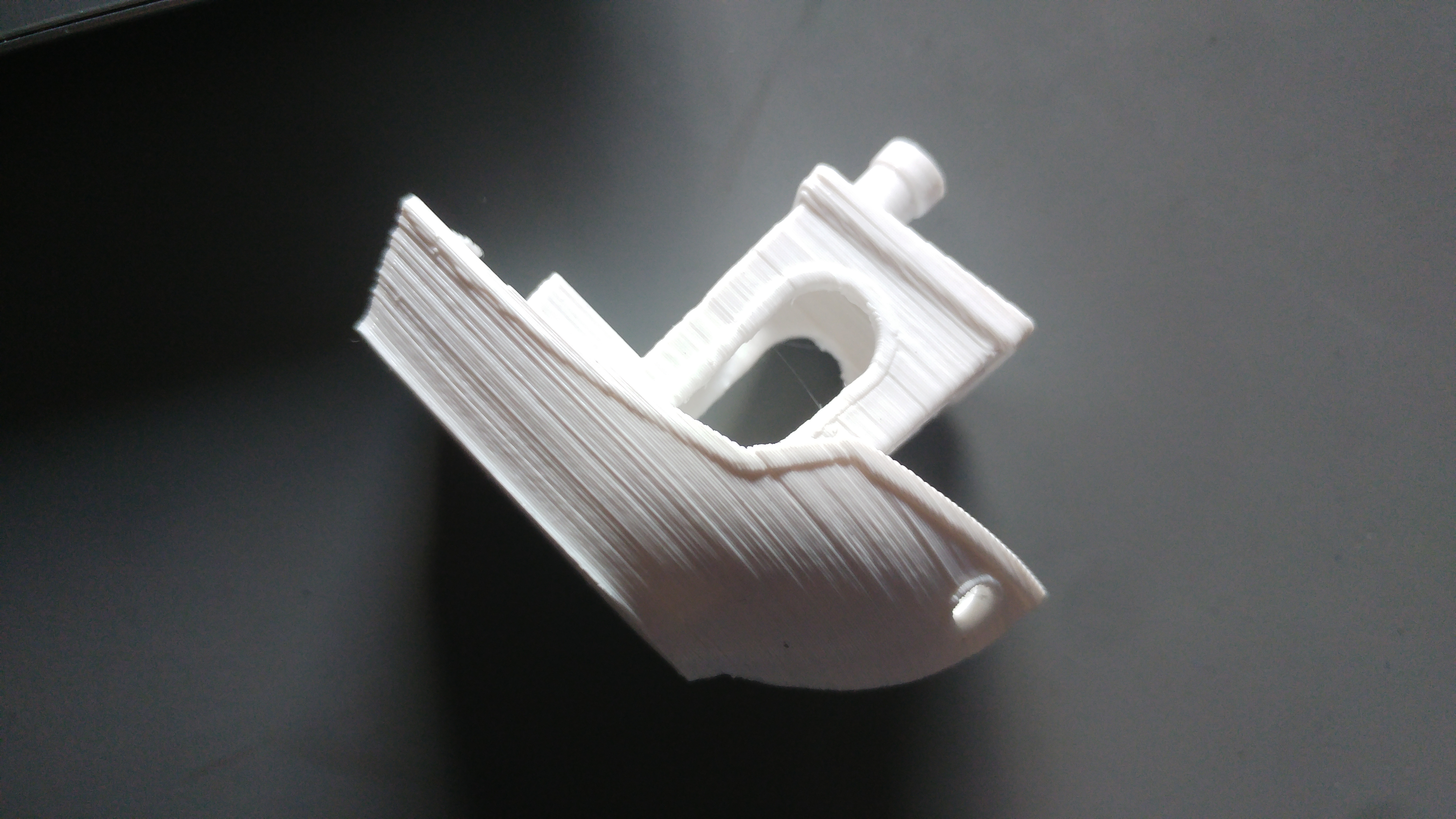

Hi all, my prints are getting worse over the weeks and I don't know
Hi all, my prints are getting worse over the weeks and I don’t know why. The layers are not exactly over each other like you can see in the picture.
It seems to be random. I suspect that my belts are a bit too loose.
Any other ideas?

Humidity issues, room temperature, both could affect printing.
Thanks so far. I have a fan standing beside it. I am printing belt tensioners, decrease the temps and try again.
I had exactly that problem, turned out my bed was loose. I’d guess its definitely something loose, either the bed, extruder, belt, pully something like that.

what hotend are you using ?
I did some adjustments:
-lowering printing temperature
-tighten all screws of the machine
-added belt tensioner
The hotend is one of those cheap things you get with the makerbot clones
I had the same problem with mi e3d v6 and I fixed it following this video
Layer lines not lining up is generally a sign that something is loose. Check pulley set-screws, check that your hot end doesn’t wobble in the holder, check that your bed isn’t wobbling. Additionally, check that your bed temp is stable (if you have a heated bed) as heating up/cooling down can cause the bed to warp up/down squishing your layer lines and giving this effect.
Try using some new (sealed) filament. It’s possible yours has absorbed a lot of moisture.
Thanks for all the advice.
I replaced the hotend barrel, nozzle and heating brick. The nozzle I use now is a .5mm one. I think the old nozzle is blocked, because the .5mm one extruded waaay better.
I wasn’t able to print a benchy yet, but I printed a g-clamp. I think the issue got better, but it is not perfect still, however I was printing at 250% speed.
