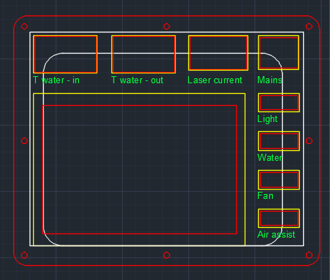

I designed a new control panel, for the dsp and switches and I am not sure what kind of material I should use. Is 4mm acrylic strong enough for it,? or will it break easily? and do you have suggestions on the color of the acrylic (I was thinking of black acrylic an then engrave and cut it out with the K40, I want it to be non-transparant). Or should I use 2mm aluminium and cut it by hand?
Here is a picture of my design in white the current and new cut out in the metal of the K40, red is cutting line and yellow the outline of the dsp/switches/meters:

I made my panel out of clear acrylic that I spray painted black on the backside, engraved the back side, the put white paint in the engraved areas. From the front it looks like shiny black acrylic with white lettering, and can’t damage the paint because it is on the back side.

@funinthefalls ​, what is the thickness of the acrylic you used? The text engraving at the back side is very clever!
I used 4mm acrylic, but I wishI would have used 6mm, the 4 is almost a little flimsy, but works. 6mm would be perfect . And back painting and engraving is a trick everyone needs to learn, you get some really nice results that way.

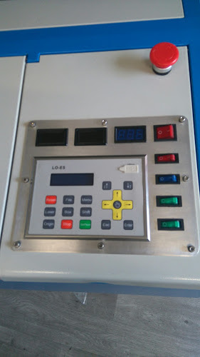

Decided to go for an aluminum front plate because that was easier for me. I am happy with the results so far. The following weeks I have to do the wiring.
