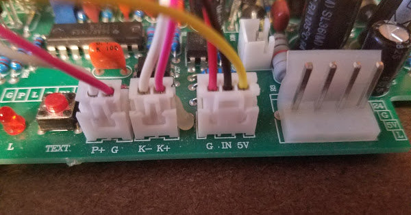

Another newbie here. I just purchased my K40, everything seems to work except that it won’t fire from the test button on top of machine (it does fire from PS test button). On the PS, there is no wire attached to the K+. Also on the control panel board, the 5 pin plug has no wire attached to the P-.
My question is, could this missing wire be the issue?
If so, does the K+ connect to the P- ?
Thanks for any thoughts or assistance!

Label K+,K- reversed
I just had a case where the K+ and K- was reversed on the silkscreen. Yours seems to be the same i.e. reversed? The silk screen is wrong, not what is on the pin. So (K- = K+) and (K+ = K-).

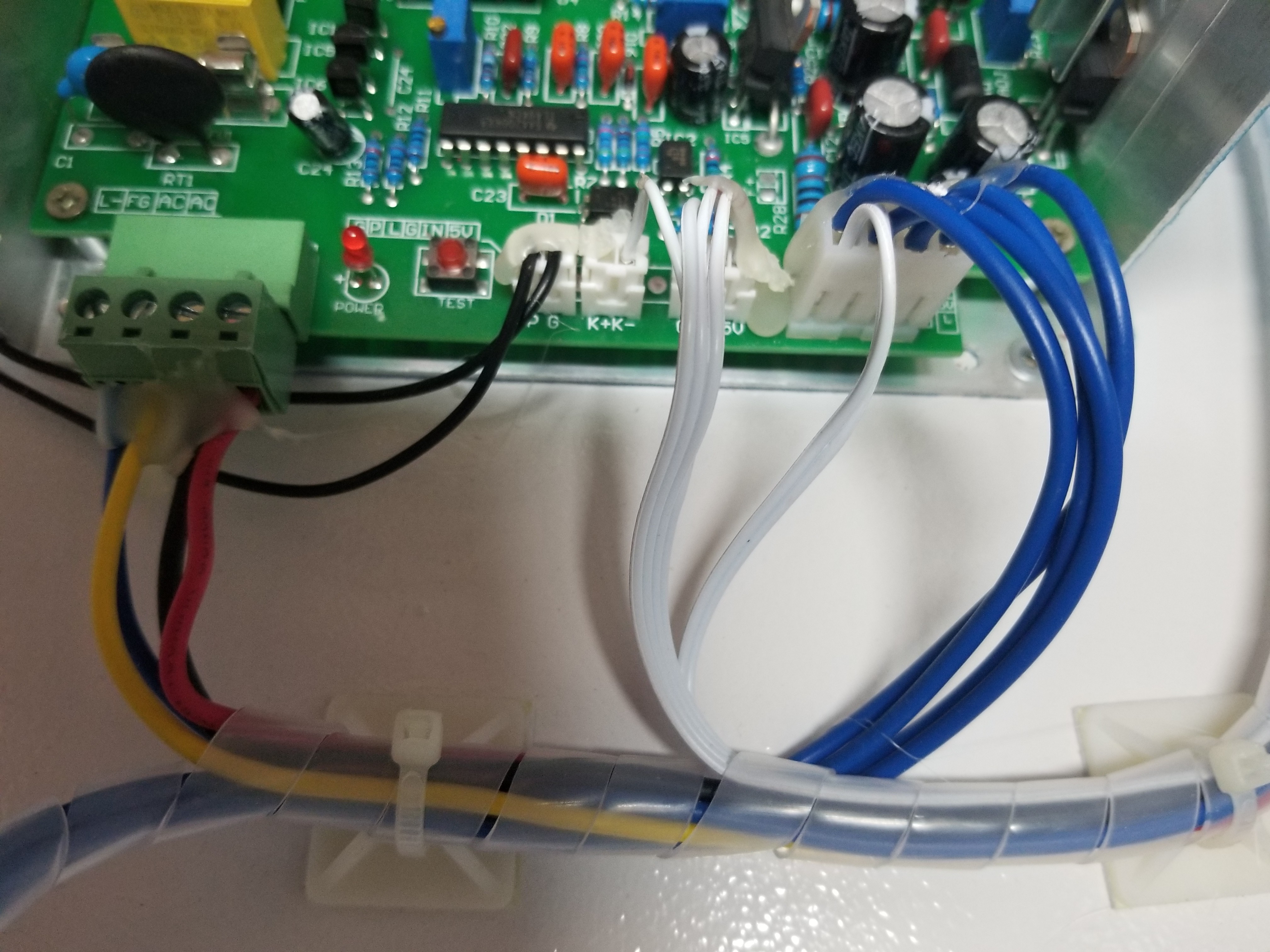

A picture of a supply with the correct silkscreen:
Conclusion
So what this tells me is that the K- is what is actually left unconnected and since K- is just ground it probably is derived from another ground up on the panel. Perhaps the G on the 3 pin connector to the right of the K+K- connector. I do not think wiring is your problem.

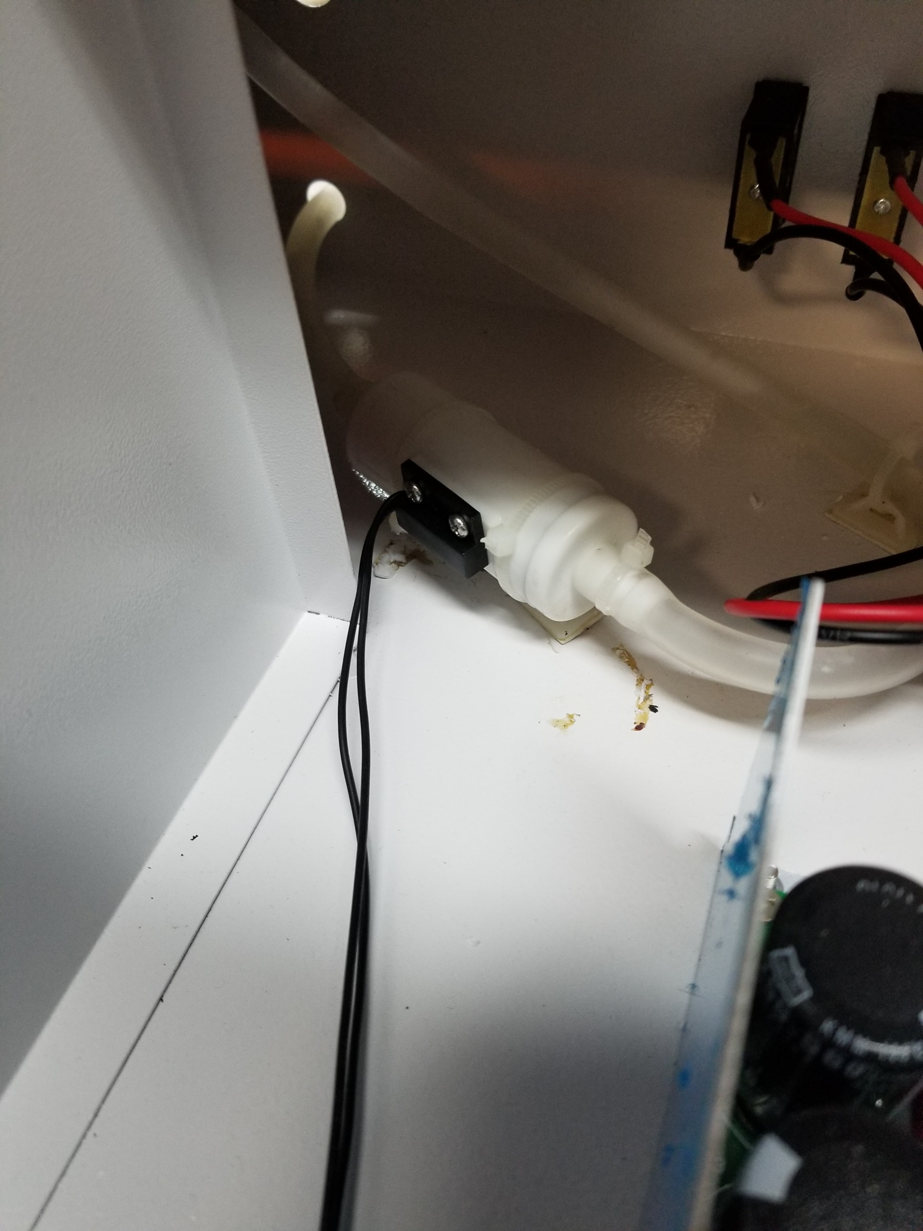

Verify Coolant flow switch
I notice that the P/G plug has 2x black wires not going to the panel?
I am guessing this is going to a waterflow sensor and then to the panel somehow?
3). Do you have a water flow sensor?
4). Is the pump working and are you running coolant through the tube?

#3. I do have a water flow sensor (yes, the 2 black wires you noticed go to it).
#4. The pump is working and I am running coolant/water through it.
#5. Those wires go to a LED strip light in the cutting area.
Below is picture of my water sensor. I wasn’t sure if the test button on the PS would fire if the water sensor was not working?

I think I was doing this as you were typing : ) It appears to me to be a NO switch and water flow should close it via a magnet. I used a meter for continuity and my switch was not closing when I turned the water pump on. So I used an external magnet on the switch and the test fire button is now working.

I actually think the problem is with the part in the flow “tube” not moving or not being strong enough to activate the switch (since an auxiliary magnet works with switch).
Either way, my bypass is temporary. I will get a proper working flow sensor.
