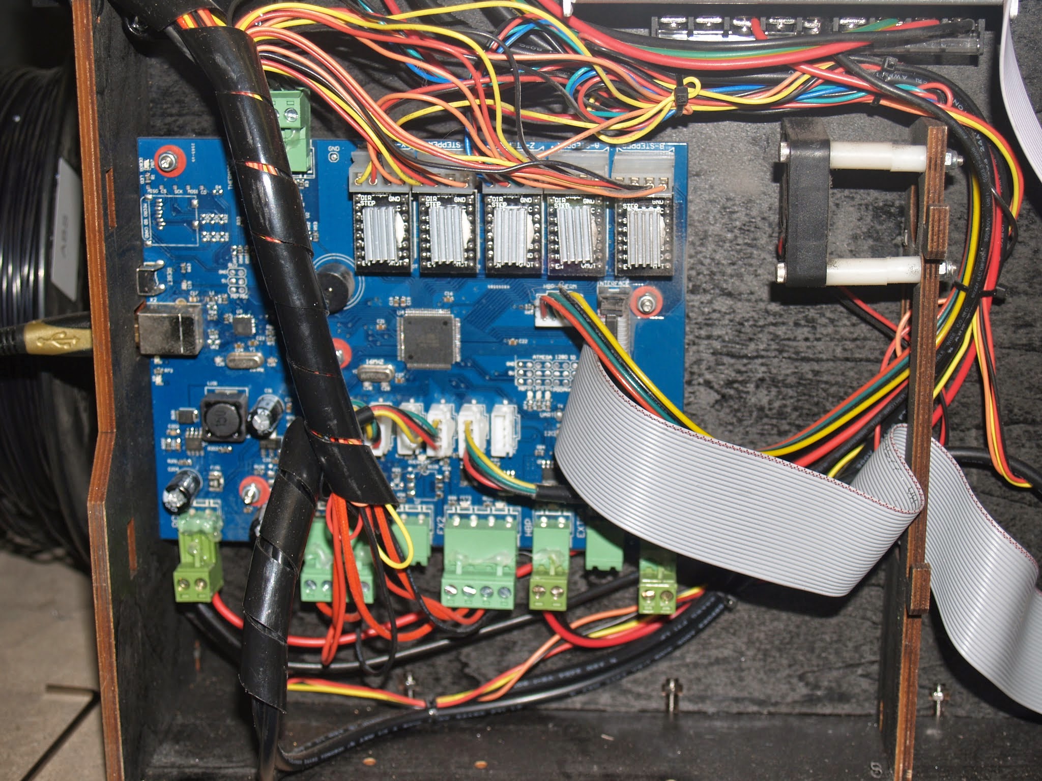

Hi can any body tell me where i can get a new mother board
Hi can any body tell me where i can get a new mother board from like in the photo its from a cheap copy of a makerbot problem is i have power to the board but no signs of life
any help much appreciated LEZ
Does the board respond to serial commands? If it’s a dedicated boatd it’LL Be very difficult to make a diagnose, I suggest you to replace it with a combo arduino mega 2560 + RAMPS 1.4, I assume you can reuse (or try to) the same stepper driver you have, you can buy everything very cheaply on eBay
Yea get a ramps 1.4 looks like you have pololu steppers and many of your connections will plug in
Second that just replace it with ramps or azteeg and rewire it.
I, too, recommend replacing it with arduino/ramps
Hi All many thanks for your input I have ordered the arduino/ramps and will no doubt be back for more info on how to fit
