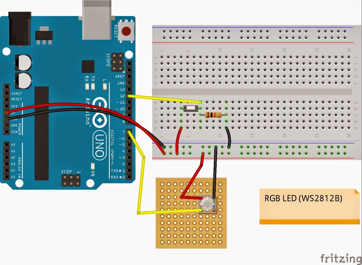

Hi, can anyone point me in the right direction. I am trying to turn on and off a WS2812b LED from a button.
My code compiles OK, but when i upload it the LED is red and when i push the button it goes green.
I would like the LED to be off and when i push the button it goes Red and stays red when i release the button.
