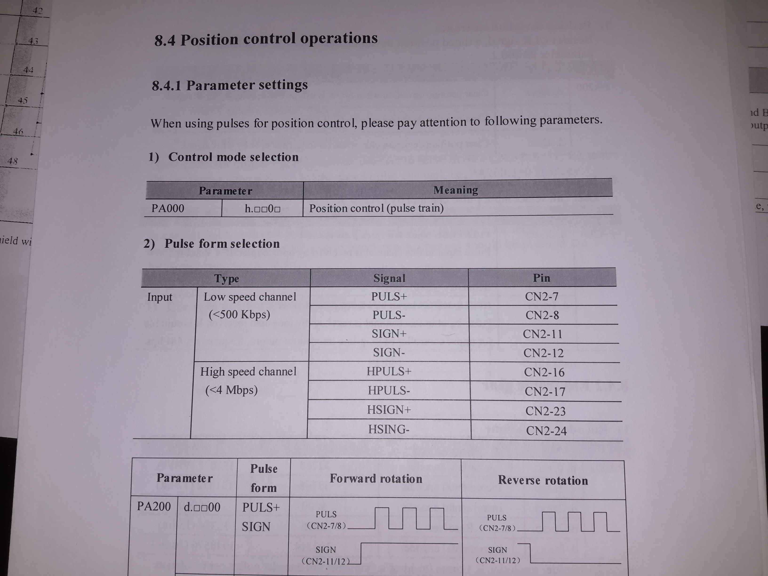

Hi, can someone of the smoothie team please check, if the solution Ray and I developed will work or not?
Originally shared by Marc Pentenrieder
Hi,
I just discussed with Ray how to connect my external servo controller to the remix board with external stepper adapters.
We got to the conclusion, that it would be best to use “open collector, option 2” (see pictures) with a 5V psu and smoothieware configured as open drain on the EN,DIR(Sign),STEP(Pulse) pins.
It would be nice if someone can have a look at it and proove it right or possible wrong.
Any suggestions are apreciated.
