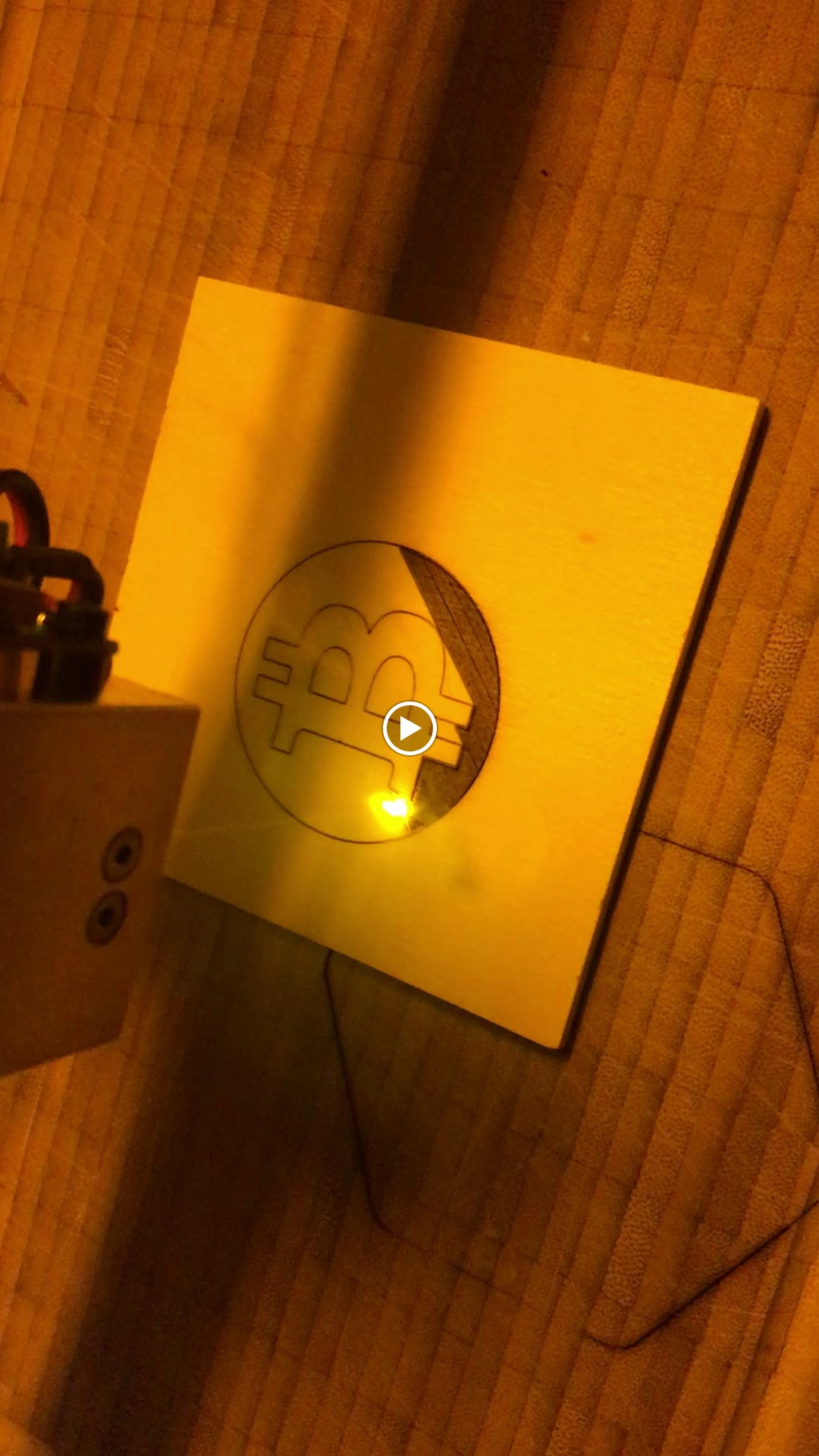

I’m kind of new to Laserweb. The build of my LED laser took way longer than expected and so I was only able to get it running yesterday. I run it on a PI3 connecting to a Smoothieboard.
After some trying here and there it’s basically running and all works well.
