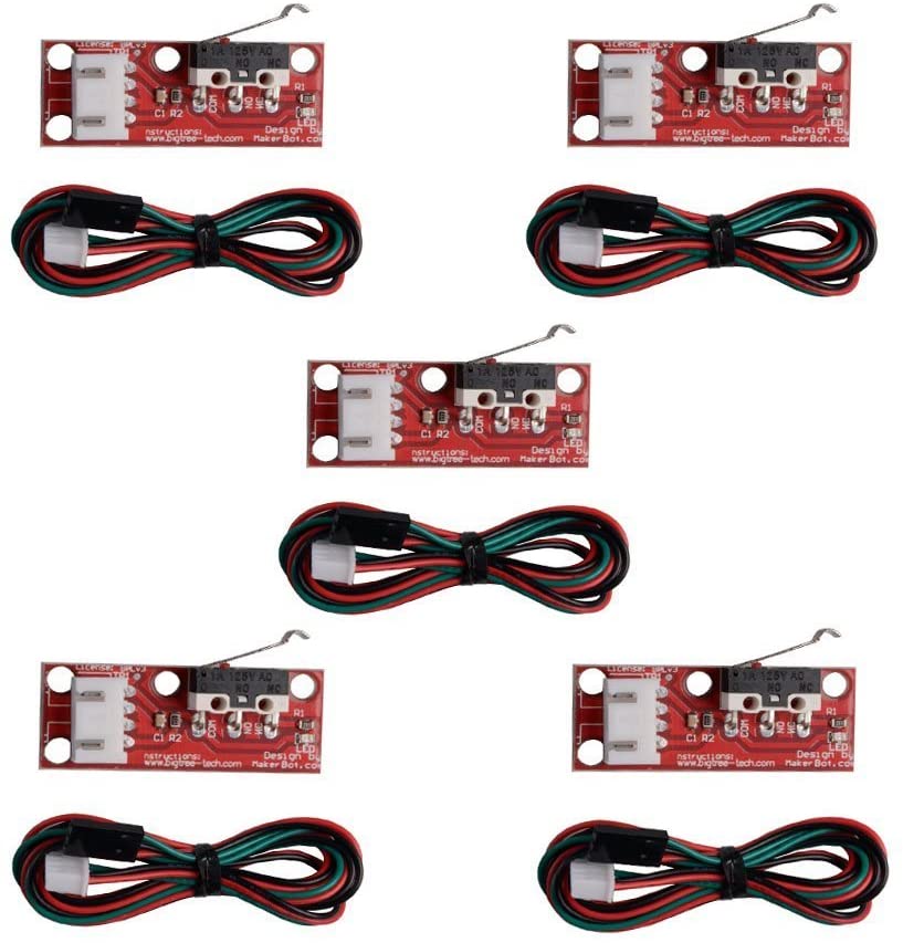

The linked switch assy. are a nice way to modular-ize the connections. They may need to be modified to run in series configuration. I have a set on order to find out if and how.

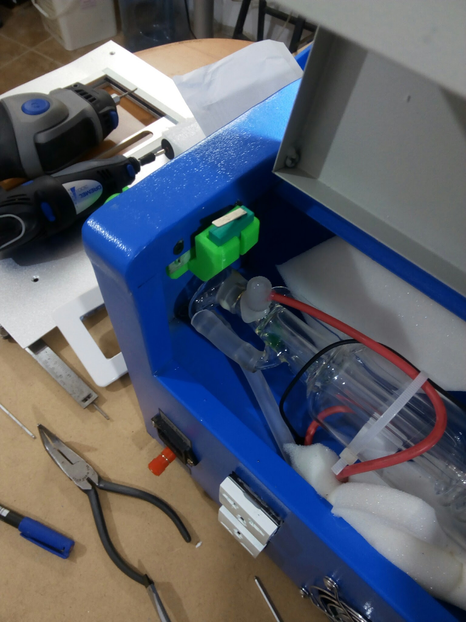

Thanks +Don Kleinschnitz, I was looking for a good place to put the switch on the laser tube cabinet physically. I made up one, printing right now. I will post when installed :slight_smile:
Et voilà
Nice, any chance I could get the stl file for that mount
k40 printed helpers found on #Thingiverse k40 printed helpers by jorgerobles - Thingiverse
Thank you very much
They are printing now
