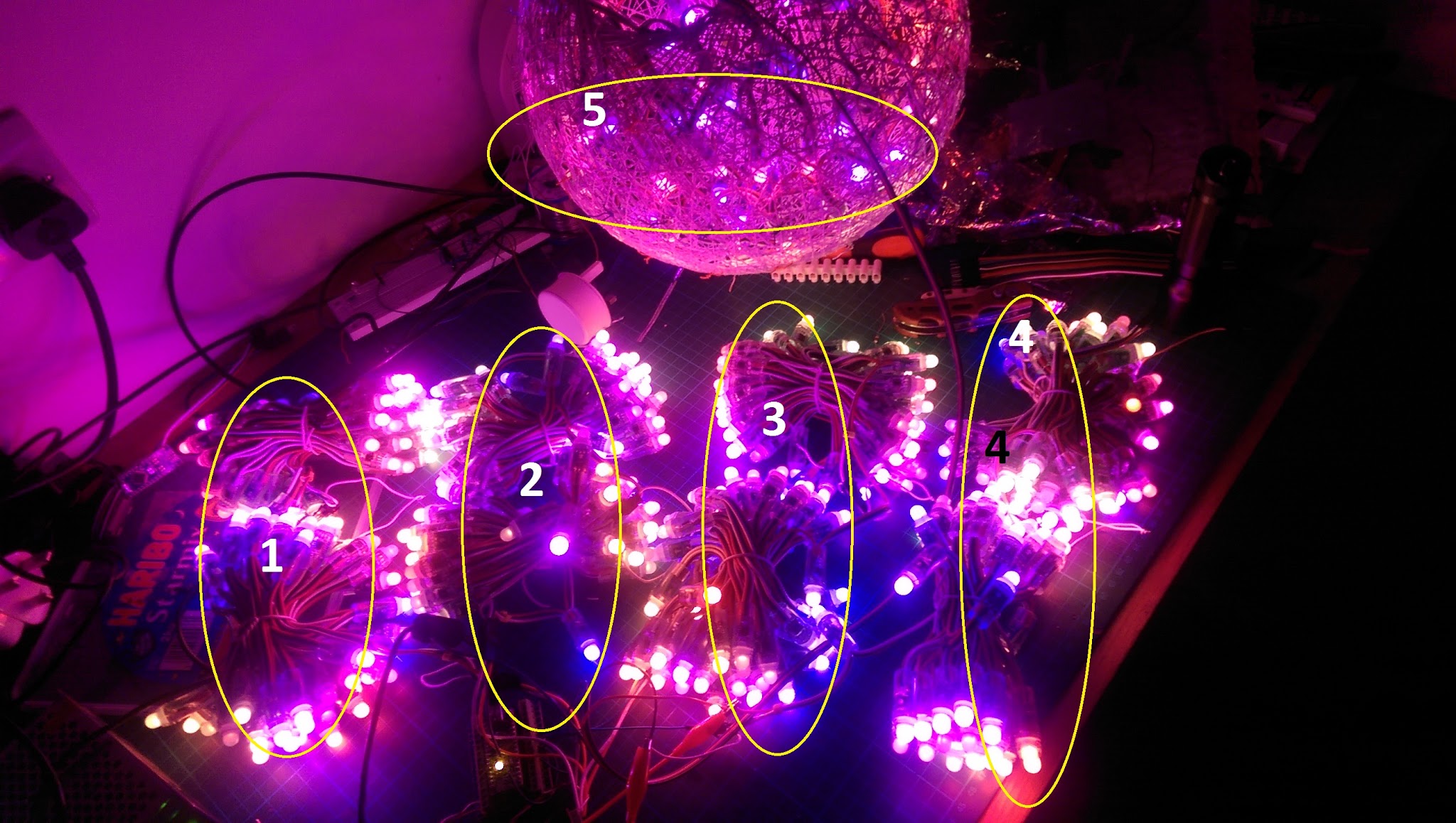

could some one be kind enough to point me in the direction to run different pattern on multiple strips please. This is what i’m try to achieve
  1. run few patterns identically on all the 5 strings at the start
  2. then 1,3,5 stings will have a solid fill Red and 2,4 strings to have Blue (may be, I will try running different patterns later)
    3)then all start up again.
I managed to use Marks Timecode example to do the patterns and run the way I would like to, with Mark and Marc’s help, thanks again.
tried few ways to address each string in the program but no joy.
any help would be much appreciated.
thank you
please see the link below for the two ways(only the beginning) I have tried to do this
pic show all the strips running the same pattern

Hi Mark I tried the following (with the help of a different example, naming each strip) it compiles and uploaded but nothing happens
this the code
thanks for your kind support.
