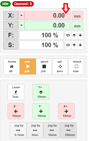

im having a problem with x and y coordinates. when i move them in laserweb they dont change.

hi, if i put $10=0 (which is very useful for real time track) it set automatically the offeset as this “Work Offset: -109.66 / -300 / 0 / undefined”
is it possible to stay with offset 0 /0 / 0 ?
