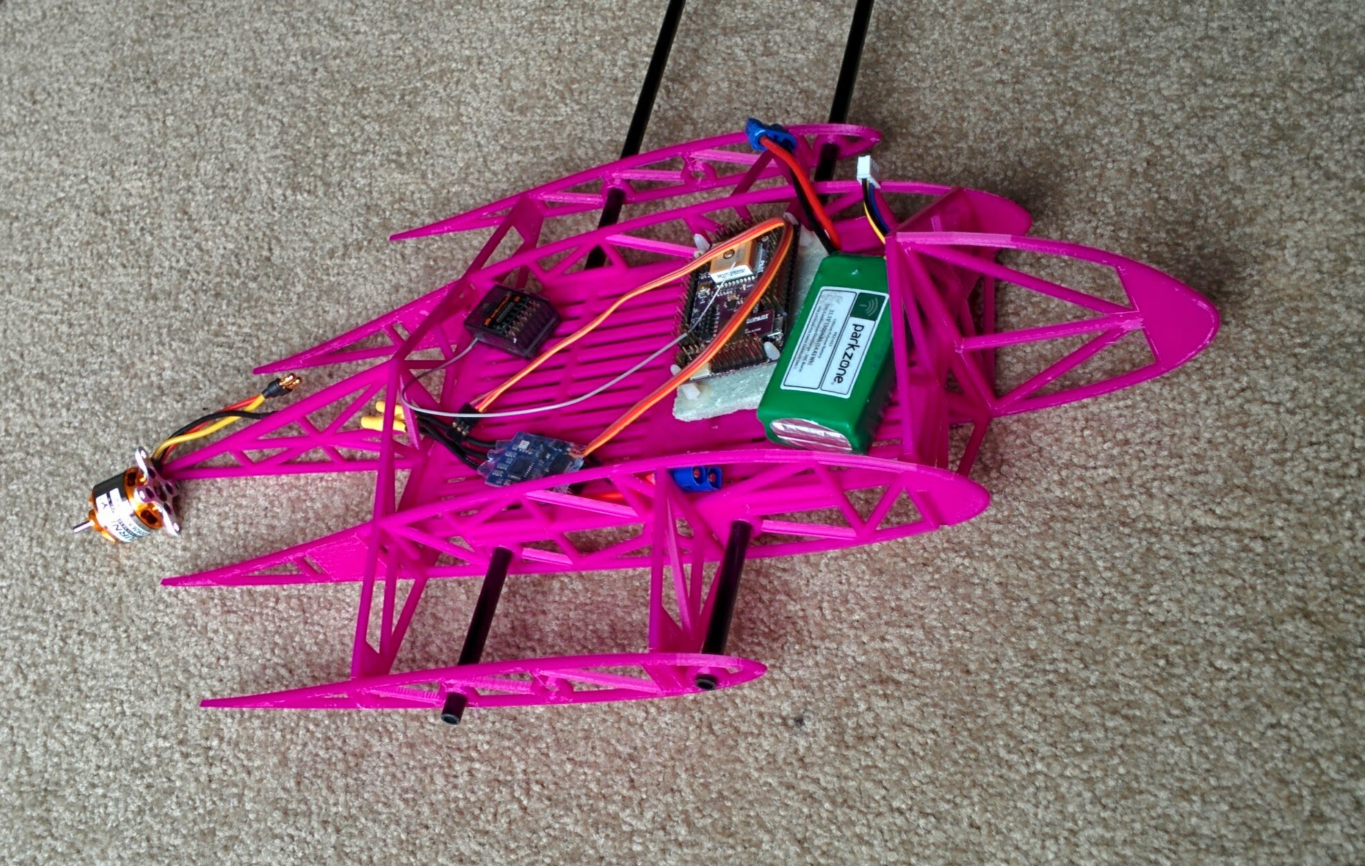

Hi everyone, Check out my latest progress.  This is just a mock up to
Hi everyone,
Check out my latest progress. This is just a mock up to test fit the ‘fuselage’ parts and check tolerances. I’m designing it like I would design a balsa/ply airplane model. The skin will be made of a combination of thin balsa and later I’ll add shrink wrap (your traditional “Monokote”). I’m currently using Thick CA and kicker to glue the PLA parts together. It works, but there must be something better. I’d normally use epoxy for wood models, but it doesn’t bond that well with PLA.

If your struggling to glue the PLA why not use ABS? That way it can be easily bonded with acetone/ABS juice, plus will have a degree of flex compared to PLA
My design will be for the Go Large. But don’t worry, parts that are too large for your printer can be split just like I’m doing now with my current printer. I can demonstrate how to do that.
Because I’m taking on a large work load, I need to keep features to a minimum for my branch. Imagine that I’d have to design and prototype both the regular design and the split-parts modifications… My first goal is to show the viability of this approach and encourage others. And at the same time I’ll get to show off the usefulness of a large build surface for model aeronautics.
Perhaps someone in the community will take up the torch and produce STLs that are printable by their printer. This is the benefit of a creative commons. We can remix and mod the design.

@Andre_Roy What filament plastics are you printing with?
There’s alot of tough filaments out there that could be of your interest. Except from nylon with very good streght, but hard to print. You could test Taulman T-Glase (PETT) for example, or Polycarbonate. I am experimenting with T-glase my self atm, will update in the tread as it progresses.
@David_Baron PLA. I like it for many reasons.
Yes, files will be open. Taulman bridge shows the most promise, I think.

That is awesome. Something I’ve thought about but have not put time in on yet. Main question is the weight comparison to a traditional balsa / ply build. I would think it could be lighter using trusses in the ribs like you have done; making for better performance all around. Can’t wait to see the final build and flight.
