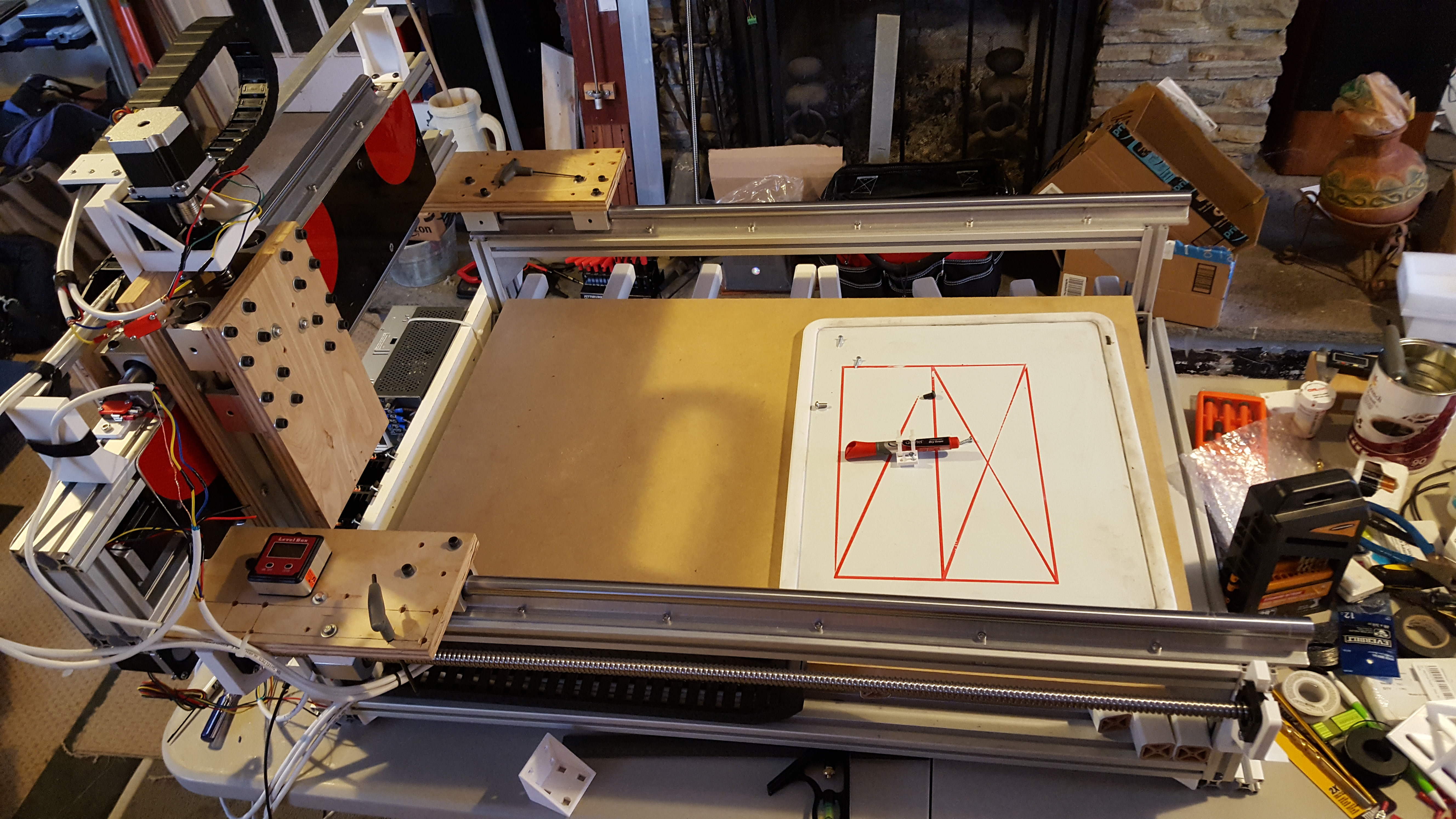

Hi everyone, hoping for some guidance on finalizing how I am using GRBL to run tool paths (from Fusion 360) using UGS… Here’s a pic my machine - the whiteboard was done using manual Gcode commands with a marker mounted. The whole things is still WIP, but I’m now trying to cut air to confirm all is functioning properly.

This picture was taken after homing. Y is far left, and X is close to camera. Z is homing up high. The home switches are installed and the machine homes to all 3 fine. But… in this position, UGS will indicate that the Machine Position is at the negative soft limits. My travel limits in GRBL are (X=500, Y=900, Z=100). So in the home position, my Machine Position is (-498, -898, -98). So all Axis move in a positive direction from home, but from a negative number… Does not seem correct. Thoughts?
But,… when I begin to run a Gcode file, all 3 Axis move diagonally to the opposite side from Home before as the program begins… So effectively the machine went from Homing to a Machine Position of full negative limits on each axis (-498, -898, -98) to starting the job from a Machine Position of (0,0,0). Am I using the UGS “Reset Zero” correctly? Should I flip the operation of my steppers motors? Should I being setting some other Work Coordinate System as well as adding a line of Gcode to my file to tell it to go to that working coordinate space to begin?
And finally, the Axis of my machine are (partly?) inverted. Definitely my Z Axis is moving down the the bottom of the work surface that then ‘machining upwards’, raising upwards to cut. It seems like my X Axis is a mirror image too, but maybe my Y Axis is not… All are wiring the same. Feels like I should flip the motor coils, but I am not sure what that will do to my Homing. Maybe I need to flip the coils and also flip the GRBL Home direction setting?
