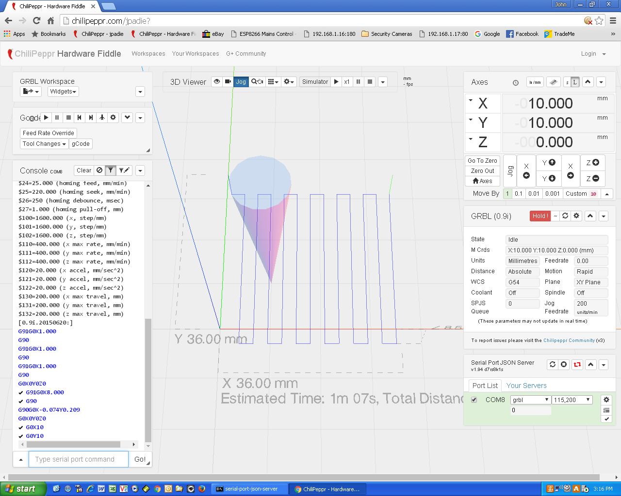

First Image: Chilipeppr_on_WIN_XP
Second Image: Chilipeppr_on_WIN_10
Looks like you aren’t getting any info back from your Grbl device. Are you sure you’re connected with Grbl buffer chosen in serial port list?
Thanks John for the reminder – that was the issue – the serial port list not configured properly. Great stuff, thanks once again.
