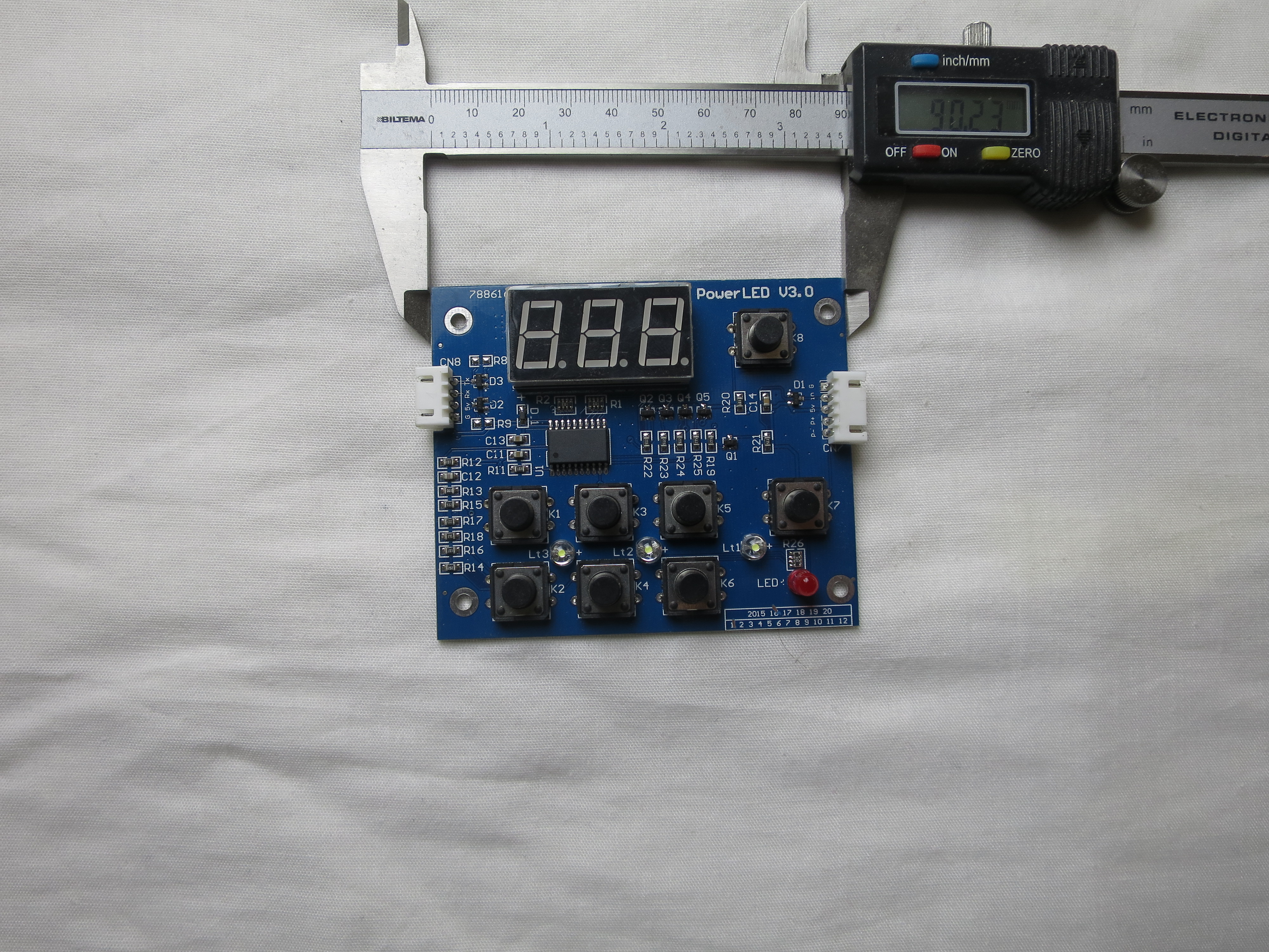

@Camarda_Neon_Salerno apparently there is something wrong with either the connection to pin P2-1,2,3 of the LPS or the other end of that cable assembly where it plugs into that control panel card (Right connector on the picture below).
I would look for bad connections or broken solder joints on that board and the corresponding cables that connect to the LPS P2.
If you do not find anything then you may have a board board (pict. below).
