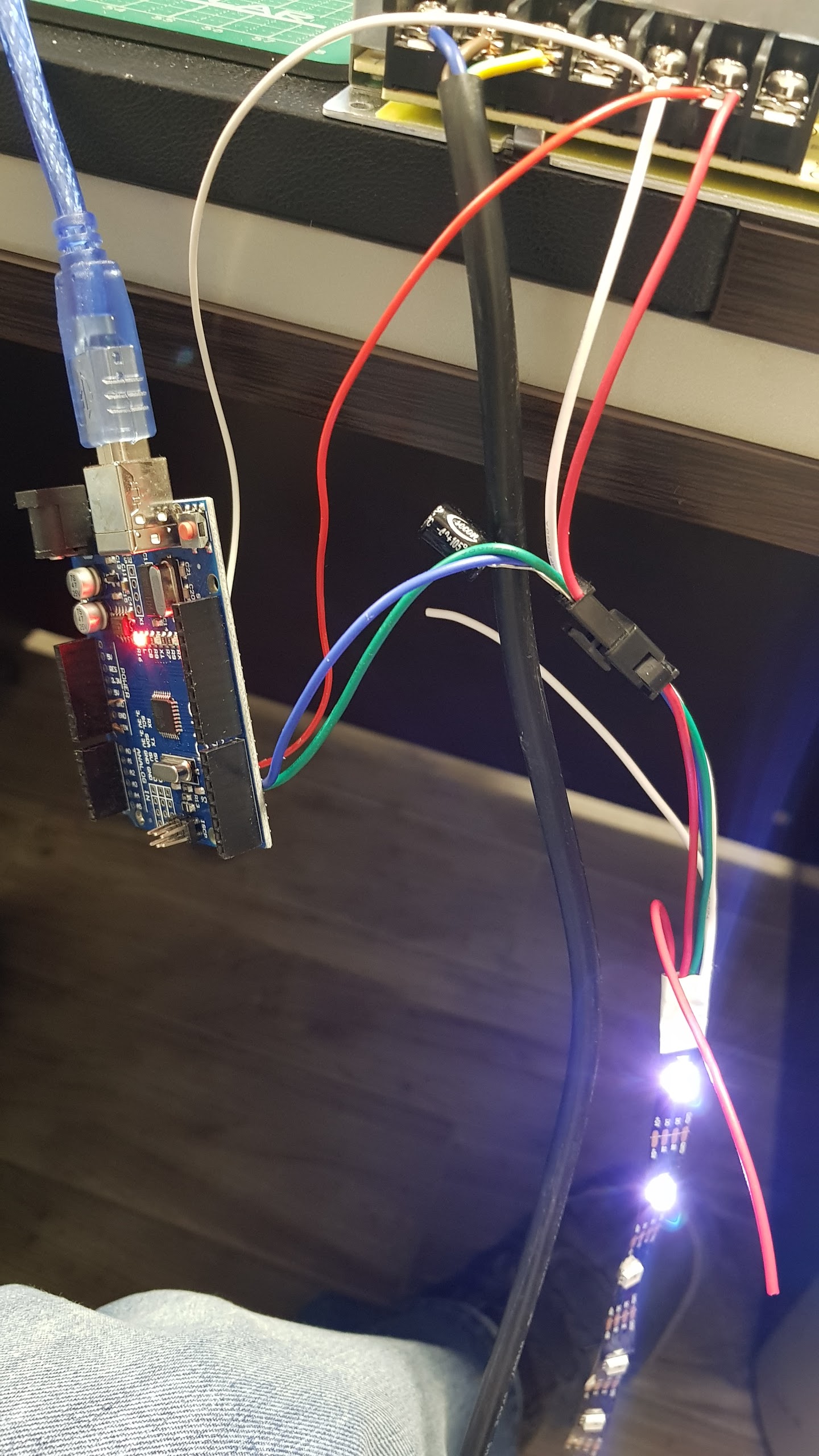

Hi Everyone,
I want lo light up 1st led but first 2 leds lit up. same things happen for other leds, if i want to light up an even led, it works, but next led also gets lit. if I want to light up an odd led, nothing happens.

you forgot to hook up the other wires. That’s your problem. Look into wiring and code for that particular strand.
@Scottie_D369 The loose ended white and red wires in the photo are extra - and + connection points (where power could be injected on longer multi-strip runs). Power looks to be hooked up correctly. Are you seeing something else missing?

@Murat_Yavas Can you share a clear close up photo of the strip connection solder pads so we can see the pad labels?

can you make a closer photo? and what are the labels ?
Looks like WS2813, tried using that in the addLeds call as the LED_TYPE/CHIPSET?
Now I see they are ws2813
thats ws2813 . I think
For Ws2813 Both Data lines should be connected together to the same data pin on the Arduino etc. Ws2813 strip will work ok if only the DI line is connected and BI left disconnected, but in this config the first LED will not work as the chip expects the same data on both inputs. After each LED chip the BI line from the input of the first chip is directly connected to the DI input of the next chip (which is also connected to the D0 of the first chip. Therefore only one Data pin is needed to feed both inputs and is connected to both DI and BI inputs.
https://github.com/FastLED/FastLED/issues/374
My connection seems appropriate.
