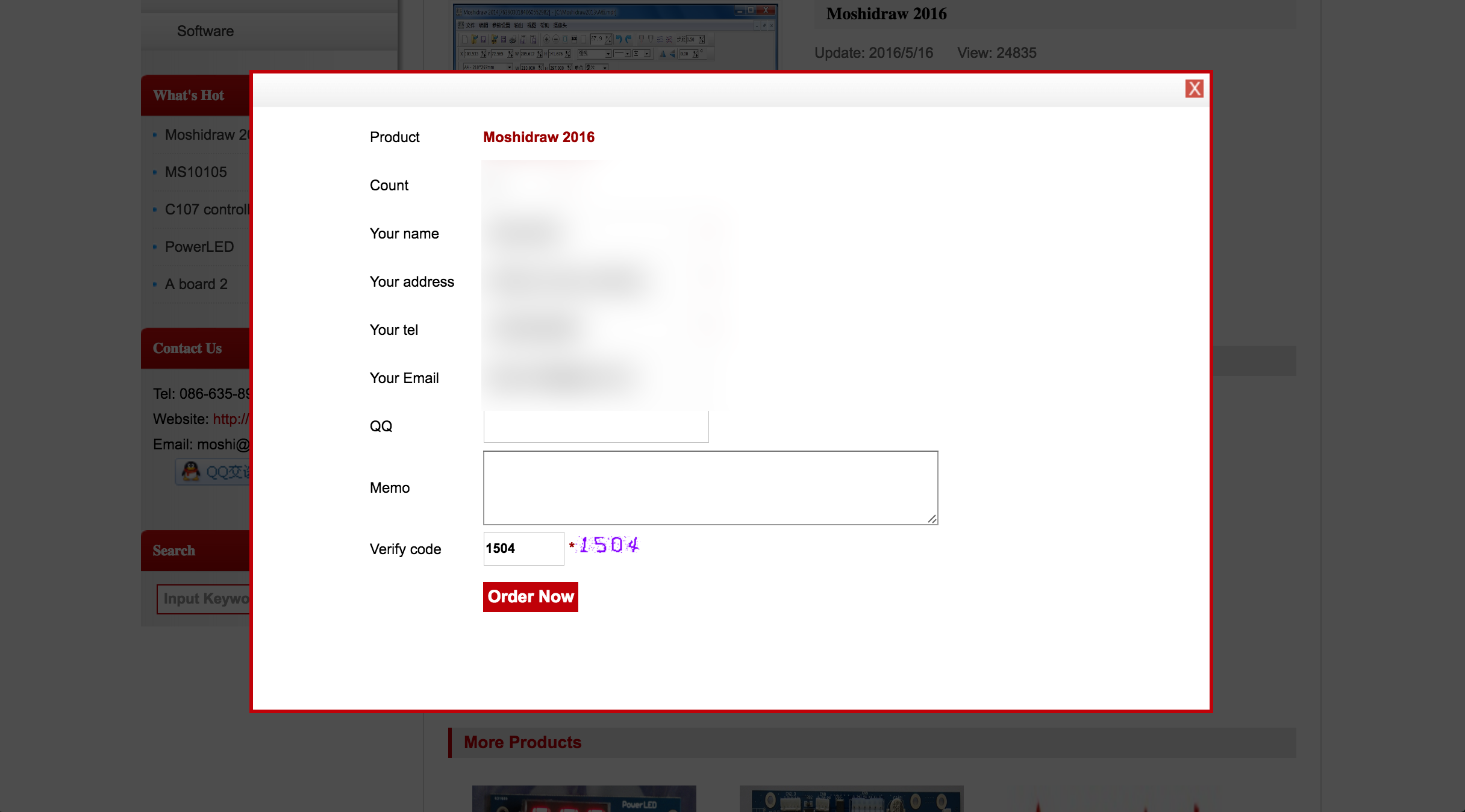

Hi everyone, just bought the K40 from ebay and trying to get it set up. Unfortunately I only have Macs and none of them have CD drives so struggling to sort the software. I’ve managed to install parallels so I can run windows but now struggling to find moshidraw. Every time I go to the website I’ve seen mentioned on here before, whenever I try to download the file I just get ‘bad request’ so not sure what’s going wrong. Also I have an orange dongle if that helps? Any help would be massively appreciated. Cheers

Cheers @Paul_de_Groot , but yeh like @Yuusuf_Sallahuddin_Y said it’s even just getting the software that I’m having trouble with. Whenever I go through this form I just get a popup saying ‘Bad Request’. I’m not sure which model, I’ll double check tonight. Cheers everyone
